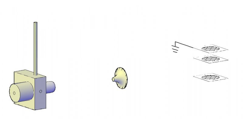

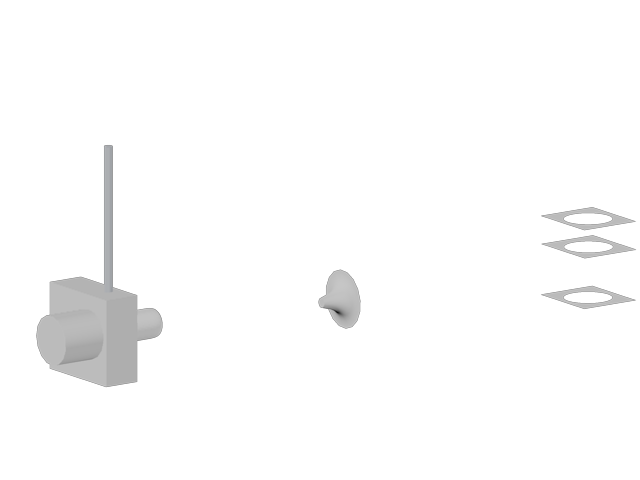

daautocad2010 Posted June 12, 2011 Share Posted June 12, 2011 hey my apologies in advanced since I am not helping you with your question, but I have a rendering issue and need some help. I have an instrument drawing with 3d and hatch meshes and some lines. When I render the image the lines and meshes I have do not show up. is there any way to fix this? I know rendering is only for 3d objects (now that I have read up on it) but what about the lines in a drawing that you need to see in the final image? any advice will be greatly appreciated! Quote Link to comment Share on other sites More sharing options...

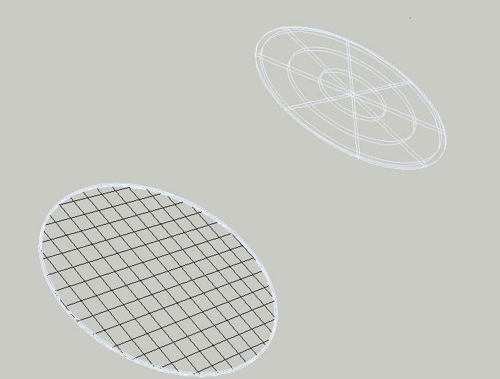

daautocad2010 Posted June 12, 2011 Author Share Posted June 12, 2011 Cad64, Thanks, that makes sense I wasnt aware of norms in forums. ReMark, the meshes are a model of a stainless steel plate with a wiremesh at the center. this I have drawn as a block, the block shows up when rendered but not the mesh in the center which is part of the block. the lines are representing some plates that are grounded. so I have drawn them similar to a paper drawing of a grounding with three lines of decreasing length with the longest line connected to the plate thats grounded. Quote Link to comment Share on other sites More sharing options...

daautocad2010 Posted June 13, 2011 Author Share Posted June 13, 2011 Hi, I attached a screen shot of the drawing as well as the rendered file. Cheers, Quote Link to comment Share on other sites More sharing options...
daautocad2010 Posted June 13, 2011 Author Share Posted June 13, 2011 looking at it now for my purposes even the screen shot looks ok but would still like to find out more about this issue of lines and meshes not showing up in the rendered file. Thank you. Quote Link to comment Share on other sites More sharing options...
Patrick Hughes Posted June 13, 2011 Share Posted June 13, 2011 For rendering purposes look into creating a "mesh" material using an image file. Create a solid representing the screen and apply the mesh material. Quote Link to comment Share on other sites More sharing options...
daautocad2010 Posted June 13, 2011 Author Share Posted June 13, 2011 Patrick, if I understood you right, you are suggesting creating a mesh material using the Mesh Modeling tab? I used a mesh cylinder but when rendered its smooth, im still curious to know how to get lines and a wire grid to show up on rendered files. any help would be greatly appreciated! on 4th Jul 2007 02:53 pm CAD64 wrote "You can't apply a hatch pattern to the face of a 3D object, but you could draw a boundary polyline around the face of the object and then hatch that. You will need to adjust your UCS and align your XY plane to each face you want to place the hatch pattern. You need to keep in mind that the hatch will not show up when you render though. The correct procedure is to apply materials to your 3D objects." Quote Link to comment Share on other sites More sharing options...
Cad64 Posted June 13, 2011 Share Posted June 13, 2011 In other programs, like 3DS Max, you can produce a "wire" render, as discussed in this thread: http://www.cadtutor.net/forum/showthread.php?42232-Wireframe-Rendering. But as far as I know, you can't do this in Autocad. Quote Link to comment Share on other sites More sharing options...
Patrick Hughes Posted June 13, 2011 Share Posted June 13, 2011 Patrick, if I understood you right, you are suggesting creating a mesh material using the Mesh Modeling tab? I used a mesh cylinder but when rendered its smooth, im still curious to know how to get lines and a wire grid to show up on rendered files. any help would be greatly appreciated! " No, In this case forget about the term "mesh" in reference to an AutoCAD mesh. What I mean is to find a picture (.bmp, .jpg, etc) of a screen - "mesh" (which is what I'm thinking you are meaning to represent). Now create a material using that image file. When you render the screen will display the "mesh" (again - not the AutoCAD term) Quote Link to comment Share on other sites More sharing options...
Patrick Hughes Posted June 13, 2011 Share Posted June 13, 2011 Like this: Quote Link to comment Share on other sites More sharing options...
