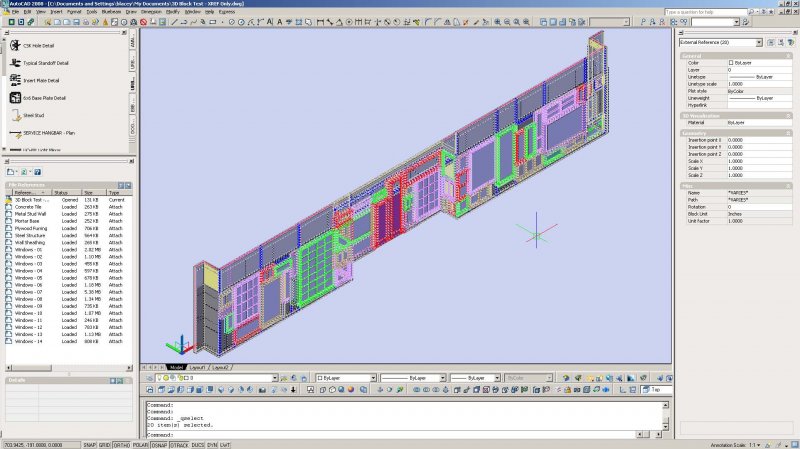

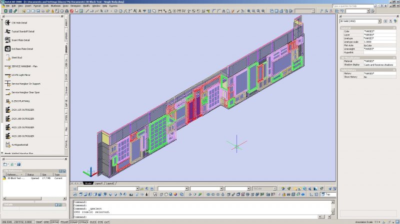

SuperCAD Posted June 16, 2011 Posted June 16, 2011 If this doesn't convince you, I dont' know what will. Solids only File Size = 17.7MB Memory Usage = 940,324K Quote

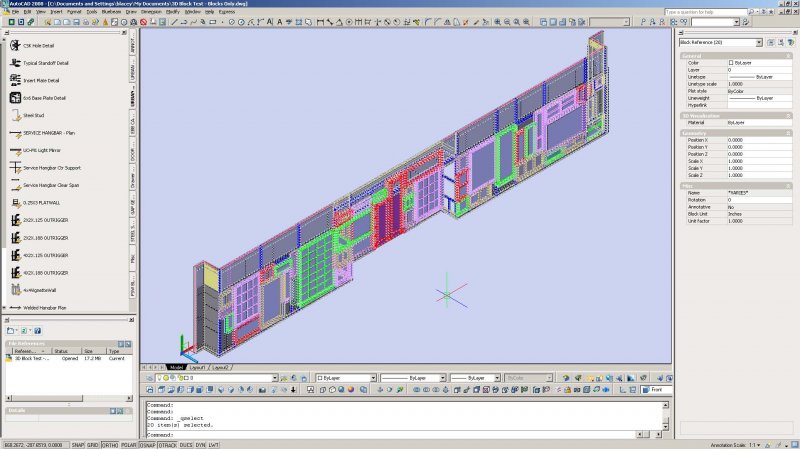

SuperCAD Posted June 16, 2011 Posted June 16, 2011 Blocks Only File Size = 17.2MB Memory Usage = 816,296K Quote
SuperCAD Posted June 16, 2011 Posted June 16, 2011 XREFs Only File Size = 131K Memory Usage = 628,788K Quote

nestly Posted June 16, 2011 Posted June 16, 2011 If this doesn't convince you, I dont' know what will. It may depending on your methodology. I assume you saved 3 versions of the file (your original made of X-refs, then where you inserted the xrefs to make them blocks, and then the one with the inserted blocks exploded) Did you restart AutoCAD each time before opening each of the 3 versions of the drawing to check memory usage? Quote
SuperCAD Posted June 16, 2011 Posted June 16, 2011 Did you restart AutoCAD each time before opening each of the 3 versions of the drawing to check memory usage? Yep. I also made sure that none of the other programs were running at the same time. Also, just to clear up any confusion, you don't "convert" files into XREFs. You simply load the DWG file using the External References box and it will load the drawing into the current working file. However, you need to be sure that there isn't any other geometry in the file, otherwise you'll need to crop/trim the XREF to block out what you don't want to see. Quote
