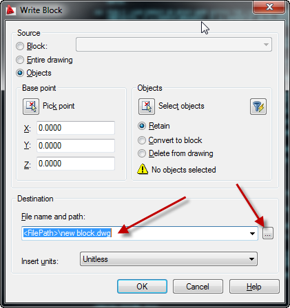

The wblock dialog has a button to both browse and named the new file already included:
... Never mind the QSELECT button in the upper right, which allows quick access to selecting all objects on a specified layer.

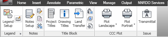

And believe me I am very used to using wblock. But I am also aware of reality and reality is that some of these guys aren't very used to CAD or experienced. I have done along of work on standards. I have creates lisps for many aspects of our work and I have created standard legend blocks and standard notes. But I realised quite early on the the carrot is much more effective than the stick.4.png
