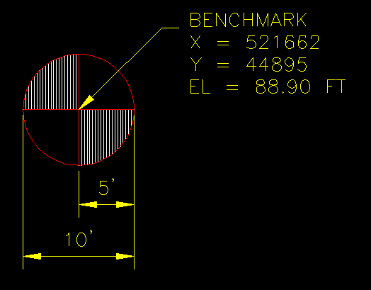

bracken2 Posted July 6, 2011 Share Posted July 6, 2011 hi, I have been working on this project, need help!! Benchmark 312, exists at the northwest corner of the survey area. it has a elevation of 88.9 feet and its coordinates are 521662,44895 For the BM symbol, use a 10-foot diameter circle bisected by a horizontal line and a vetical line. it asking me to use hatch apttern ans131, scale 2, angle 45,slelct two points in the symbol,point within the northwest and southeast quarter of the symbol. I'm not able to do this, please help Quote Link to comment Share on other sites More sharing options...

BlackBox Posted July 6, 2011 Share Posted July 6, 2011 No worries. Sometimes a picture helps things make more sense: Quote Link to comment Share on other sites More sharing options...

bracken2 Posted July 7, 2011 Author Share Posted July 7, 2011 ok, the pic. help, but how did you break the hatching up Quote Link to comment Share on other sites More sharing options...

Car5858 Posted July 7, 2011 Share Posted July 7, 2011 ok, the pic. help, but how did you break the hatching up Use the hatch command, and pic opposite quadrents top and bottom. By just picking 2 of the four quadrents your drawing will look like rendermans drawing. By changing the angle of the hatch in the dialog box, you change how the hatch is displayed. I advise you to use the preview button this will show you what it looks like before you accept it. Never explode hatches your asking for more problems then it is worth. Quote Link to comment Share on other sites More sharing options...
bracken2 Posted July 7, 2011 Author Share Posted July 7, 2011 breaking hatching up (exploding) is an offence punishable by death in these parts Did you mean something different? Yes, I quess I did, by looking at the pic. you have two parts that has the hatching in them, that what I'Mm talking about, I'm A student in this class, I feel like these 6 project I need to finish is kicking me. Quote Link to comment Share on other sites More sharing options...

qball Posted July 8, 2011 Share Posted July 8, 2011 If your units are in feet and inches it will look something like this: Command: cc CIRCLE Specify center point for circle or [3P/2P/Ttr (tan tan radius)]: Specify radius of circle or [Diameter]: d Specify diameter of circle: 10' Command: l LINE Specify first point: Specify next point or [undo]: Specify next point or [undo]: Command: LINE Specify first point: Specify next point or [undo]: Specify next point or [undo]: Command: h HATCH >> Forced layer S-HAT Pick internal point or [select objects/remove Boundaries]: Selecting everything... Selecting everything visible... Analyzing the selected data... Analyzing internal islands... Pick internal point or [select objects/remove Boundaries]: Selecting everything... Selecting everything visible... Analyzing the selected data... Analyzing internal islands... Pick internal point or [select objects/remove Boundaries]: Pick or press Esc to return to dialog or <Right-click to accept hatch>: Command: Command: *Cancel* Commands: CIRCLE (Diameter 10') LINE (Osnap to Quadrants) HATCH (Pick internal points, 2 of the 4 quadrants or chambers of the bisected circle, with the specified hatch pattern) fin edit: I only read the last post, not knowing it had been answered. I thought this was the thread from the other day where everyone was getting frustrated with lack of information. Quote Link to comment Share on other sites More sharing options...
