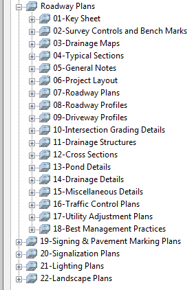

BlackBox Posted July 8, 2011 Share Posted July 8, 2011 I work in Transportation, and typically have large plan sets... anywhere from +/-100 - 550 sheets, and also use SSM to keep my projects organized. All sheets being included (attached) to the DST must reside in the same directory as the DST to which they are attached. Also, I use sub-sets to keep my DST organized: ... Which is how we quickly navigate to the correct sheet needed, etc.. Each sheet (for us) is in its own drawing (intead of multi-tabbed drawings), as we typically have 2 (or more) CAD users working on the same project, at the same time. Using SSM makes it easy to know which drawings are in use, or available for work, etc. Hope this helps! Quote Link to comment Share on other sites More sharing options...

rkmcswain Posted July 13, 2011 Share Posted July 13, 2011 I work in Transportation, and typically have large plan sets... anywhere from +/-100 - 550 sheets, and also use SSM to keep my projects organized. .......... Also, I use sub-sets to keep my DST organized: [ATTACH]28547[/ATTACH] ... Which is how we quickly navigate to the correct sheet needed, etc.. Each sheet (for us) is in its own drawing (intead of multi-tabbed drawings), as we typically have 2 (or more) CAD users working on the same project, at the same time. Using SSM makes it easy to know which drawings are in use, or available for work, etc. Hope this helps! Ditto all of that except: All sheets being included (attached) to the DST must reside in the same directory as the DST to which they are attached. I agree it is good practice to keep all DWGs in the same directory, but that does not have to be the same directory which contains the DST file. We keep the DST in the root of the project and the drawings are in a subdirectory named DWG Quote Link to comment Share on other sites More sharing options...
BlackBox Posted July 13, 2011 Share Posted July 13, 2011 I agree it is good practice to keep all DWGs in the same directory, but that does not have to be the same directory which contains the DST file. We keep the DST in the root of the project and the drawings are in a subdirectory named DWG You absolutely right - I honestly didn't remember that until after I went into a DST for something unrelated to this thread, and saw the "Store new sheet DWG file in:" option, under the sub-set properties. I failed to come back and correct this post, as I got caught up in deadlines. As always, I appreciate the correction, RK. Cheers! Funny (but sad) side-bar: As it happens I'm Beta testing my State's DOT Civil 3D Kit, and they (unfortunately) come from a Microstation background, where the project template's directory structure has 50+ sub-directories (I know!?)... in any event, instead of using sub-sets assigned to their predetermined sub-directories (as you've just clarified), they spent tax payer dollars to hire Autodesk .NET Developers to write them a custom "Sheet Set Organizer" application which sits on top of SSM, so that each of the 50+ directories can have their own DST file. Quote Link to comment Share on other sites More sharing options...
