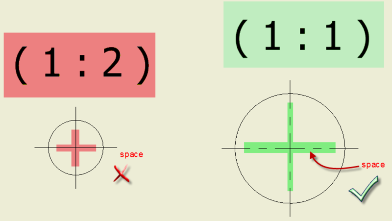

Faouweb Posted July 13, 2011 Share Posted July 13, 2011 Hi, I have some trouble with the Center Mark Style, if the scale is 1:1 it's OK, but when I change the scale I can't have the distance A and B as shown on the picture. What I need is LTSCALE for Inventor Thank you. :wink: Quote Link to comment Share on other sites More sharing options...
Faouweb Posted July 14, 2011 Author Share Posted July 14, 2011 there is no solution I have tried higher and smaller number but nothing changed. Quote Link to comment Share on other sites More sharing options...

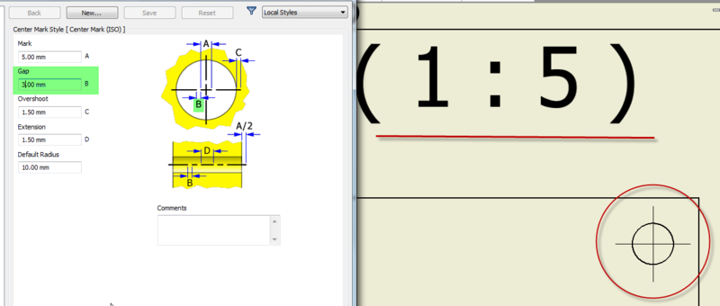

Faouweb Posted July 16, 2011 Author Share Posted July 16, 2011 This is an example If the scale is 1:1 it's OK, when i put a smaller scale the space disappear, and I can't fix it in the Style Editor. Quote Link to comment Share on other sites More sharing options...
JD Mather Posted July 17, 2011 Share Posted July 17, 2011 Why can't you fix it with the Styles Editor? Quote Link to comment Share on other sites More sharing options...
