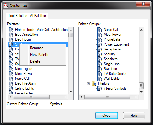

cadman6735 Posted July 19, 2011 Share Posted July 19, 2011 Hi all, I am following the AutoCAD help menu and it is telling me to go to the ManageTab, Cusomization, Tool Palettes and to Import-Export a palette or palette group to simply right click on the palette or palette group. I am right clicking but I only get: New Group Rename Delete Set Current I see nothing about Importing or Exporting. any ideas, thanks oh, I also want to add a custome palette to the profile so when I share my profile all users get the same tool palette, (I am having trouble understanding how to do this) Thanks again Quote Link to comment Share on other sites More sharing options...
SLW210 Posted July 19, 2011 Share Posted July 19, 2011 Here is what i get... Quote Link to comment Share on other sites More sharing options...
cadman6735 Posted July 19, 2011 Author Share Posted July 19, 2011 Yep, that is what I am looking for... Do you think there is a setting that will unlock those two options? this is all I get... Quote Link to comment Share on other sites More sharing options...

cadman6735 Posted July 19, 2011 Author Share Posted July 19, 2011 See if THIS is of any help. Yes, This is the current way I do it already, I open the contentbrowser and basicly eyedrop them onto the user palette. I was looking for a more managble way of doing it. We just upgraded from AutoCAD2008 to AutoCAD2012 and I am setting up the company standard profile and figured I could add the palette to the profile one time and call it done. When I first started here the drag and drop method was the way the old cadd manager did things and this is how he showed me how I should do it too. I was thinking that maybe there is a better way. . I thought there was a way to make project specific palettes and have them load with a profile. Quote Link to comment Share on other sites More sharing options...
cadman6735 Posted July 19, 2011 Author Share Posted July 19, 2011 (edited) found my answer, it doesn't help me though, we don't use ProjectNavigator... For anyone else who sumbles across this post: http://exchange.autodesk.com/autocadmep/enu/online-help/BLDSYS/2012/ENU/pages/WSfacf1429558a55dec759ddffb0eba94718db.htm and another link that might work for me http://autocadmep.blogspot.com/2007/05/tool-palette-management-in-network.html Edited July 19, 2011 by cadman6735 Quote Link to comment Share on other sites More sharing options...
