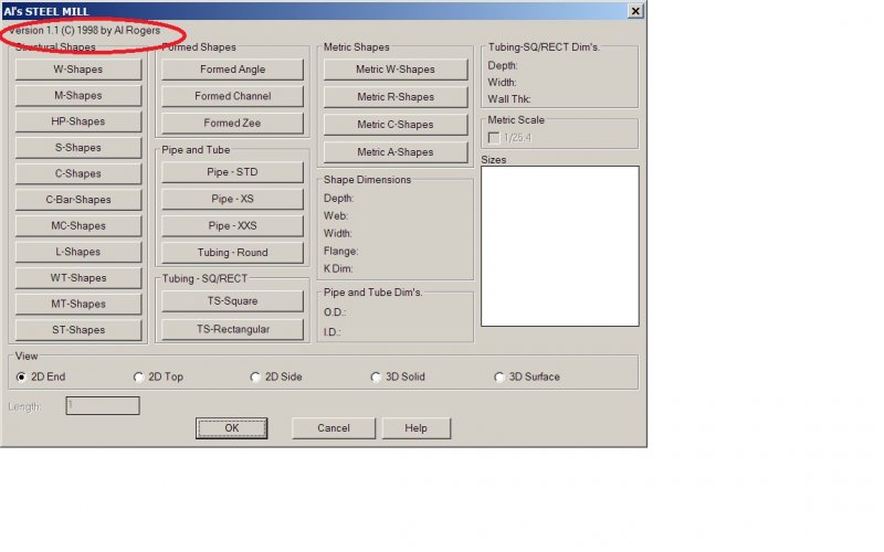

nestly Posted July 26, 2011 Posted July 26, 2011 OMG, that's a total rip off of Al Roger's Steel Mill which I've been using for several years. I don't see any reason why it wouldn't work because it appears to contains everything from Steel Mill. Make sure you have the directory where the lisp is stored in your support path. If you can't make it work, I'll link you to Steel Mill as I know that does work fine in 2012. Quote

nestly Posted July 26, 2011 Posted July 26, 2011 (edited) Not "Austrailian" per se, just the metric W/R/C/A shapes shown in the screencap above . While Googling, it appears that others have had similar problems with Steel Mill doing nothing after typing the shortcut to start the lisp. I loaded Wiseys in my 2012 and it seems to work fine. I'd try again to unzip all the files into the same directory, and then make sure that directory is in your AutoCAD2012 support path. I originally found Steel Mill at Cadalyst.com and it's still available from there http://cadtips.cadalyst.com/standard-blocks/steel-shapes-all-types-and-sizes AutoCad Steel Mill Addon.zip Edited July 26, 2011 by nestly Quote
