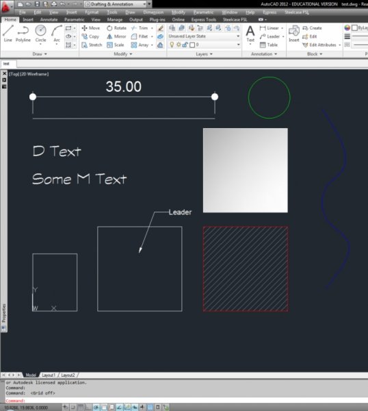

f700es Posted November 8, 2011 Share Posted November 8, 2011 In AutoCAD 2012... In current DraftSight.. We have lines, rectangles, spline, hatch, gradient hatch, dims and colors. Created in Acad and opened in Draftsight. The spline is there just does not show up in the jpg for some reason as well. Quote Link to comment Share on other sites More sharing options...
The Mad Cadder Posted November 8, 2011 Share Posted November 8, 2011 I'd be curious to know if you could do an ID check in the two programs and see where the geometry landed in each...On the surface it looks great. I hope that made sense. Quote Link to comment Share on other sites More sharing options...
f700es Posted November 8, 2011 Share Posted November 8, 2011 I need to make a file in Acad, open in draftsight, save and then open in Acad. Quote Link to comment Share on other sites More sharing options...
