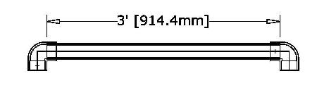

Tankman
Received the *.dwg file?
Why not change the dimstyle and see what you find?
(dim below showing the cut length for the 2" pipe).
I work mostly with inches, three decimal places but, have to provide
metric to some of my out of the USA clients.
