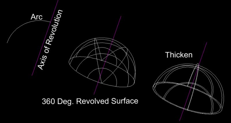

Cad64 Posted September 1, 2011 Share Posted September 1, 2011 Why don't we take a slightly different approach. See below. Quote Link to comment Share on other sites More sharing options...
ShawnTTCoop Posted September 1, 2011 Share Posted September 1, 2011 That method works perfectly. Thanks Cad64. Quote Link to comment Share on other sites More sharing options...
