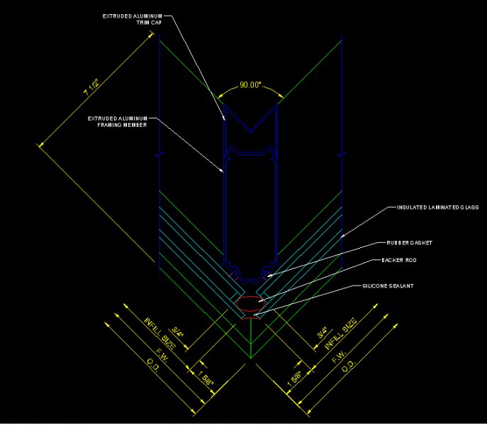

Most commercial curtain wall companies will try to talk you out of not having a framing member in the corner like that. For one reason, it is extremely difficult to make such a corner weather tight. Depending on the size of the window, framing will be necessary structurally. Glass is not a structural component, and the movements of the building due to wind, seismic activity, and weather (solar heating) must be accounted for. In the detail below, you see a single framing member shown. That minimizes the intrusion into the view, yet provides the structural stability required. I suggest you visit some of the websites for companies like Kawneer and VistaWall for ideas. They have many examples and construction details available for download.
It is possible to do your corner, but the window will be limited in size. It will be up to the structural engineer to figure out just how big your opening can be.
