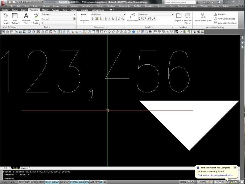

DonovanPorter Posted September 1, 2011 Author Share Posted September 1, 2011 this is there style for the level indicator , id like the numbers underlined Quote Link to comment Share on other sites More sharing options...
DonovanPorter Posted September 1, 2011 Author Share Posted September 1, 2011 ok now ive had a look at both the level indicators , and i have realised they are the same in the sense that there's has there text underlined and justified to bottom right. can one make my pointy lisp ask for justification and to be underlined ? or can it me made to do it automatically ?, i really appreciate the time , and effort in explaining these steps. Quote Link to comment Share on other sites More sharing options...
