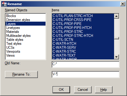

Re-name layers from C-somethign to V-something

Try this baker and it is case sensitive which means ( c- (small letter) is not equal to C- (capital letter)) .
Codes better than Command calls . :D

But I try not to re-invent the wheel where possible ;)
I have thought of that as another access to Layer name matches and I do agree that the function wcmatch is much better than vl-string-search in this case .

Not that you have to of course, but out of curiosity... if you're not going to use the RENAME command, and you're going to use vl-* functions, then why not just iterate the Layers Collection instead? :unsure:
Pseudo code:
((lambda (acDoc / )
 (vlax-for lay (vla-get-layers acDoc)
   [color=seagreen];;<-- Check / rename layers here[/color]
 (vla-get-activedocument (vlax-get-acad-object)))
If you have many layers (maybe Hundreds) in a dwg , the command call would be lazy .:)
Both are the same , aren't they ?
One more routine in Vl .:)
