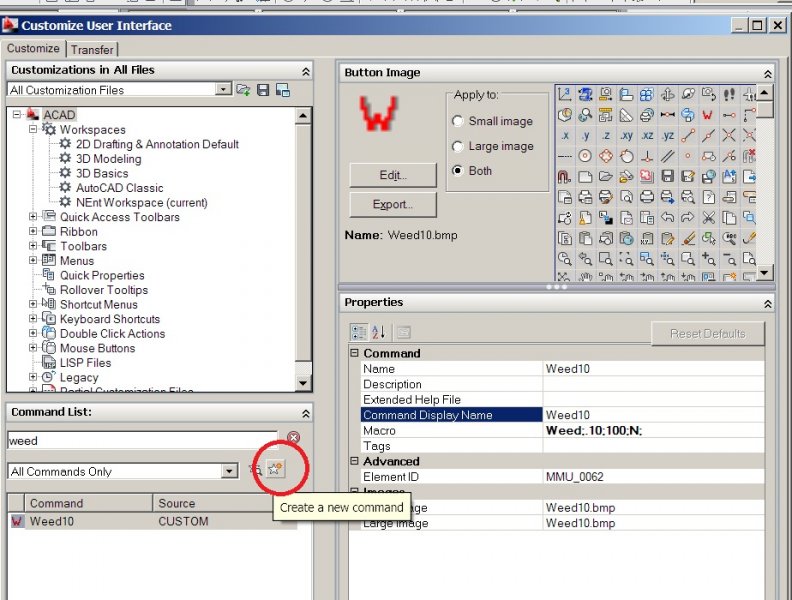

Weed.lsp needs to be automated
How to change code below that it wouldn't ask every time leg length and offset. How to put variables already to this code? Offset 0.1mm and leg length 1.2mm? Also it would delete old polyline without asking it.
After that I need only to write weed and select polyline and that's it.

Well, it's not exactly no one, because I myself have found it useful to do exactly what the OP is requesting. I didn't modify the lisp however, I added a button with a command macro.
In this case the macro would be: Weed > Offset 0.1 > leg length 1.2 > Delete original Polyline N (or Y)
Weed;.1;1.2;N;
Weed;.1;1.2;N;

That doesn't work. I tried to record this with macro recorder http://www.cadstudio.cz/dl_file.asp?ID=548 but it seems that nothing is recorded.
The modification to remove the prompts is actually quite straightforward, change:
Lines 260 - 266:
 (initget (+ 1 2 4))
 (setq max_offset (getdist "\nEnter offset distance: "))
 (initget (+ 1 2 4))
 (setq min_dist (getdist "\nEnter leg length: "))
 (initget "Y N")
 (setq e_del (getkword "\nDelete original Polyline [Y/n]: "))
 (if (null e_del) (setq e_del "Y"))
to:
  (setq max_offset 0.1)
 (setq min_dist 1.2)
 (setq e_del "N")
(Alter those values to suit, I have just used the example posted by nestly)
