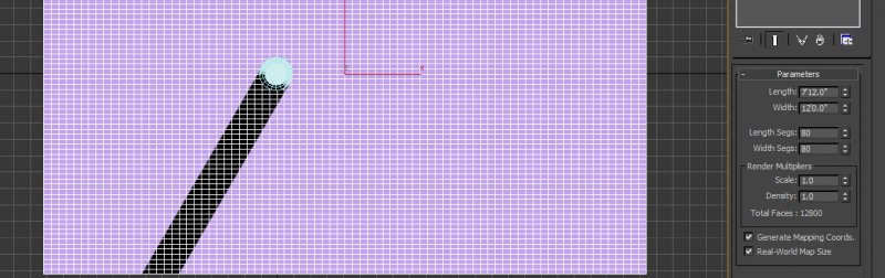

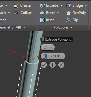

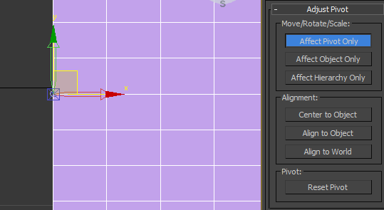

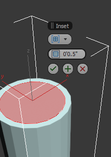

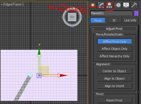

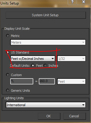

Raudel Solis Posted October 22, 2011 Posted October 22, 2011 oh come on please dont refer people to other tutorials.. help is the reason they signed up to this forum... here is the process in animating a flag... What you need A work station or adequate computer capable of simulating the flag... recommended... Core i5 minimum. 4gb of ram. 512 - 1gb graphics with a core speed of 550+ mhz to create the animation tutorial i will use 3ds max 2012 it is the same in older 3ds max versions. STEP 1... configure 3ds max units by going to Customize and then units setup Step 2. Set up your units to REAL WORLD UNITS, i will use american units. Feet w/decimal inches. Step 3.. i will now research flag pole sizes and dimensions for flags in relation to flag pole height . i found that a flag pole height for architectural purposes ranges from 20-80' http://www.united-states-flag.com/selecting-flagpole.html from this site i found a spec sheet.. which i will now use to model a flag pole *with a height of 60 feet which will sustain a flag that measures a minimum of 8*12 feet and a maximum of 12*18 feet. Step 4. I will now look up reference images from the web to get an idea of how my flag pole will look. http://tinyurl.com/62l9c7m Step 5. I will now commence in the modeling of the flag pole.. i can use to methods.. i can either create a plain boring straight cylinder measuring a height of 60 feet.. or i can get interesting by utilizing the inset feature in 3ds max.. To start i will create a the base for the flag pole a simple 4 by 4 foot box with a height of 8 inches will sustain for the scene.. although in Real life engineering is put into the design in order to sustain the various stresses it will encounter. enough of that.. now that i created the base i will create a cylinder with a 4 inch radius and a height of 10 feet "notice the segments" Step 5. I will now convert the cylinder to an editable polygon by right clicking and selecting "convert to-Editable poly" I will now switch to the polygon sub object level Step 6 Select the top polygon and inset it by .75" to bring up the parameter control i can "shift + click inset" Step 7. Extrude the newly created polygon by 30 feet same as before i can "SHIFT+CLICK extrude" to access the parameter controls. Step 8. Now i am at 40 feet. Now i will inset the top polygon this time by 0'.5" Step 9. finally i will extrude by the final 20 feet needed to attain the 60' Height. When i input 20 feet into 3ds max it may show up as 19'12" which is equal to 20 feet. Step 10. Now that my flag pole is at the desired height of 60 feet it is now up to me weather or not i add extra details to the top of the flag pole "flagpole ornament.. in this case i will not add any ornaments or decals... What i will now do is create a plane... Refering to the previous dimension sheet i will create a plane that measure 8 by 12 feet. press the T key to view the top viewport and created the plane.. and give it a hell of a lot of polygons.. the amount of segments you utilize will be limited by your system specs i will settle for 80 length and width segments Step 11. I will configure my snap to guides because they will be needed for the next steps.. to activate and deactivate snaps i can press the S key on the keyboard.. to configure snaps i must RIGHT click the button on the bar. this will cause a small window to open.. on this window i will go to the SNAPS tab and select only VERTEX and MIDPOINT. everything else must be unchecked. STEP 12 now that i have created my plane and configured my snap to guides i will rotate it to face either the left,right,front, or back viewport and align it to my flagpole by adjusting its pivot point.. first i will adjust my planes pivot point by going to the hierarchy tab and clicking affect pivot point only.now with the mouse over the plane i will right click and select "MOVE" this will make the gizmo appear if it hasn't already.. if the gizmo has not appeared press the X key, if it has not appeared as shown below ?? i dont know. step 13. now i will align my pivot point to the far left by snapping to any vertex that is the farthest to the left on my plane. i can either drag along 1 axis or hover my mouse until i see a square highlight meaning i can move along both X and Y axis. once i have aligned my pivot point i will turn off "affect pivot point only" Step 14. now with "affect pivot point only" off i will rotate my plane so that it stands just as it would be positioned on a flag pole. to do this correctly i will press the A key on the keyboard which will toggle the angle snaps on i will make sure to only rotate it on "1" AXIS to do this i will hover over the RED X axis which will highlight it yellow meaning it will only rotate on that axis. MODERATOR... PLEASE ALLOW ME TO POST MORE THAN 12 IMAGES PER POST in order to continue:unsure: Quote
