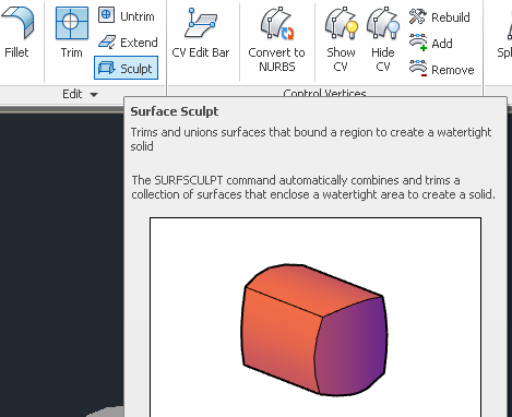

IGES can be saved as either Surface Body or Solid Body.
You need to check with the source to see what Option they used.
You might be able to convert it to a solid body with the Sculpt command on the Surfaces tab.
(_surfsculpt)
