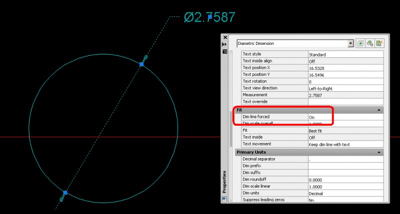

Jack_O'neill Posted September 21, 2011 Share Posted September 21, 2011 You mean like this? Ignore the red line across the circle, crosshairs got in the way. Quote Link to comment Share on other sites More sharing options...
Mickcad Posted September 21, 2011 Author Share Posted September 21, 2011 Yes! Thank you! That looks like it's in the Properties box. I'll look there. Thanks so much. Quote Link to comment Share on other sites More sharing options...

nestly Posted September 21, 2011 Share Posted September 21, 2011 I believe that's the default behavior if the text won't fit inside the circle. You can "force" two arrows with the "Draw dim line between extension lines" checkbox on the "FIT" tab of the Dimension style and/or make a child dimension style for Diametric dimensions if you don't want that line between extension lines for all your other dimensions. Quote Link to comment Share on other sites More sharing options...
Jack_O'neill Posted September 21, 2011 Share Posted September 21, 2011 That one is, just wanted to see if that's what you meant. In the dimension style dialog, look on the "fit" tab. In the lower left is a box called "fine tuning". Check the box that says "draw dim line between ext lines". To make it do it, you'll have to pull the dimension outside the circle each time. If you put it inside it, it will look like the radius dim. Quote Link to comment Share on other sites More sharing options...
