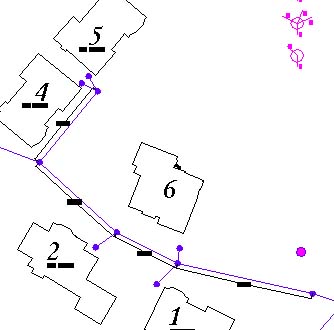

For the detail:
The items that don’t show up in the Layout 1 view are the FFL levels on the house footprints, the dimensions on the main drainage runs and the small numbers on the magenta circles.

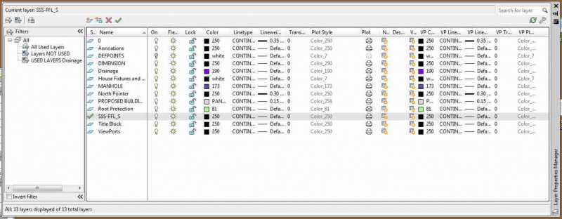

The text layers are set to Not plot in the current viewport.
When you are looking at the Layout, go into Model space and have a look at the Layer Properties Manager. Those two text layers are set to No PLot.

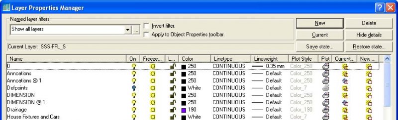

Hello Eldon - thanks for the prompt response.
I must be looking at the wrong thing.
The jpeg is an image of my Layer Properties Manager. All the little printer icons are devoid of the none plotting symbol. They always have been. But the dimensions etc are not plotting or showing in Layout 1.
I am looking in the right place – aren’t I?

I don't think that you are looking in the right place. Click on the Layout tab, so that you are looking at the Paper Space. Put the crosshairs in the viewport and double click. This should put you in Model space in your viewport. Now go to the layer Properties Manager and you can see clearly in my picture that the two layers are set to not plot in the current viewport.

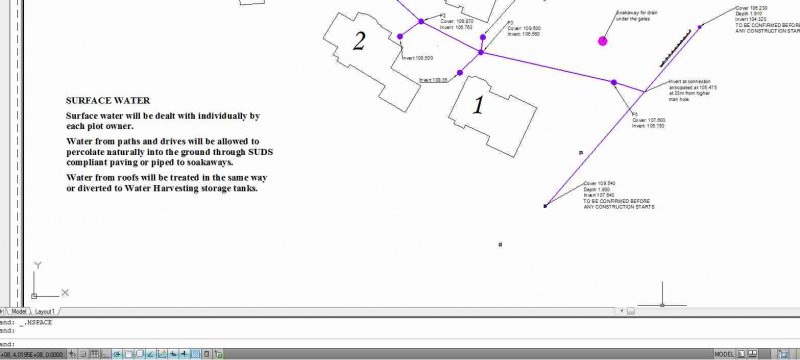

I have done exactly as you proposed Eldon.
The two jpegs clearly show that I am in LAYOUT / MODEL but the dimensions etc are not showing – they don’t show in PAPER either.

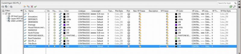

The second jpg shows the Properties Manager whilst in Layout/Model where (as far as I can see) nothing is set not to plot.
I am using AutoCAD 2011. So my screen shots are not like yours. Will this make a difference?

If you look carefully at the list of Layers, there are two that show up in my screen shot, but do not show up in yours. "Annoations @ 1" and "DIMENSION @ 1". Those are the two layers that are set to not plot in the current viewport. Perhaps you could try and name those layers differently, using alphanumeric characters and no spaces.

Firstly: I have opened your file. Guess what? The dimensions and annotations are still not showing in Layout. But the distant object has gone – what was it?
I can’t rename layers that do not exist on my list of layers. – And why should some layers be visible in your version of AutoCAD and not mine?
I have moved some of the dimensions that are on the “DIMENSIONS” layer that do not show up on the Layout view. I put them on the “NORTHPOINTER” layer. They still did not show up in the Layout view!!!
I tried the same thing with some of the no show items on the “ANNOTATIONS” layer – same result.
Similarly moving visible items from other layers onto the layers where the no show items exist has no effect. They continue to show. So is this a layer problem after all?

Your dimensions will show up in your paper space layout if you change their Annotative property from "Yes" to "No".
The same thing applies to the text (0, 1, and 2) surrounding the five circles with radial lines.

You had some items on Defpoints and Defpoints turned off. The text was set to background color.
You should move the items from Defpoints.
