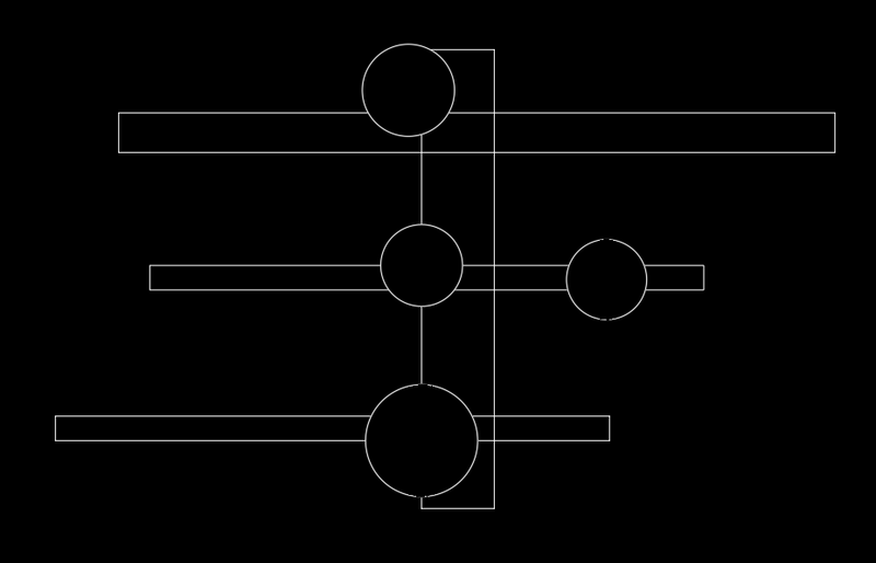

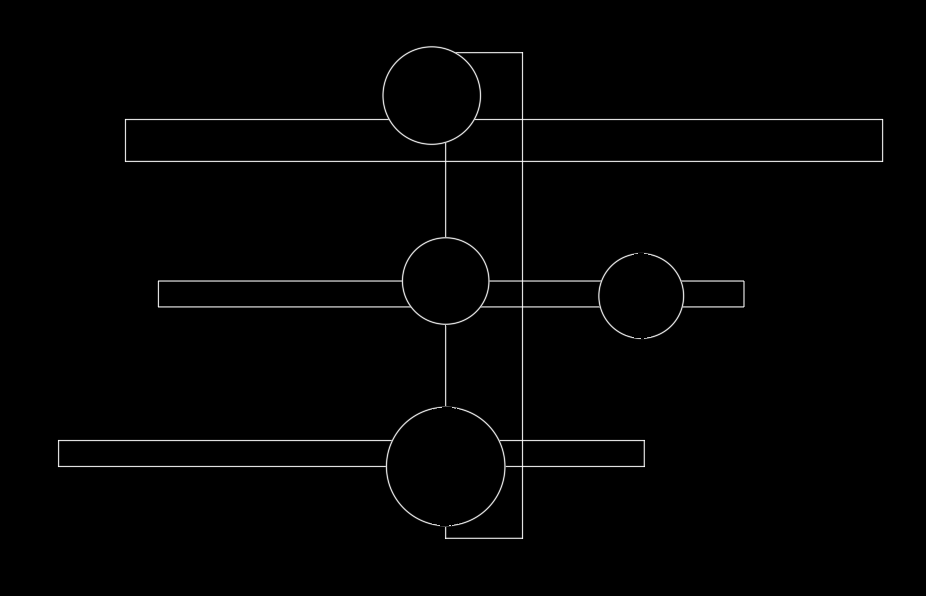

SLW210 Posted September 6, 2023 Posted September 6, 2023 I get this in AutoCAD 2022 with JustWipe. Quote

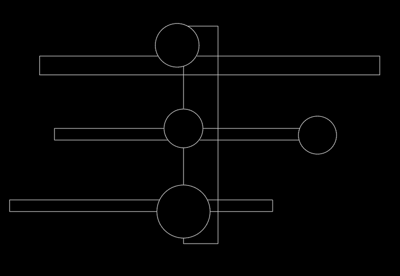

SLW210 Posted September 6, 2023 Posted September 6, 2023 Here is a Solid Hatch with the same color as the background. Quote

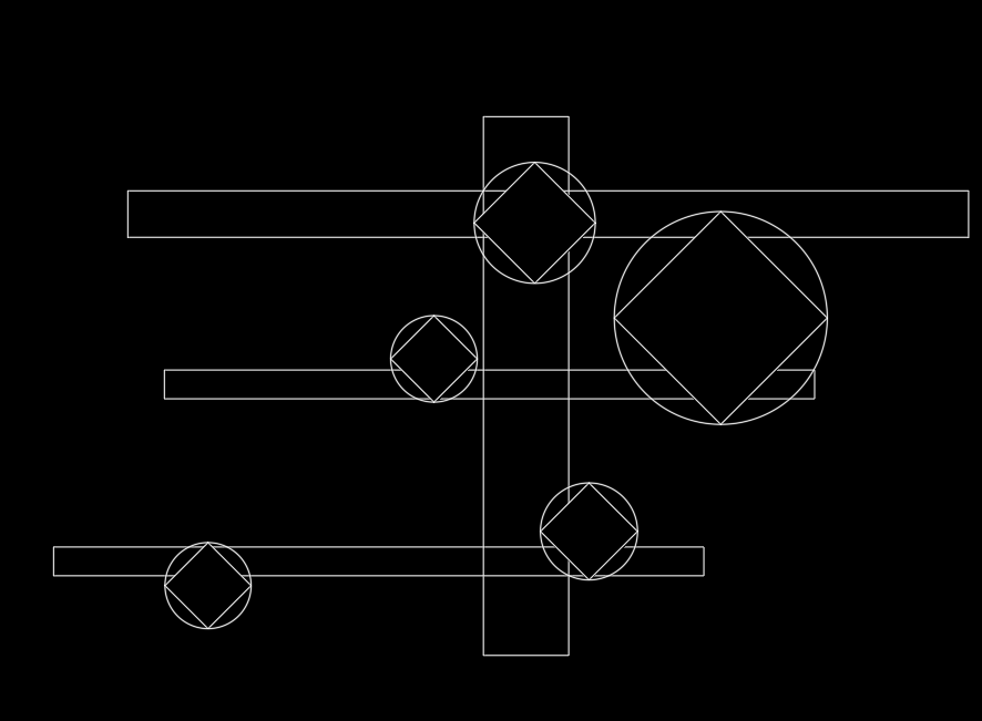

exceed Posted September 7, 2023 Posted September 7, 2023 (edited) 8 hours ago, SLW210 said: I get this in AutoCAD 2022 with JustWipe. It's interesting. GIF I posted was executed in autocad 2023. in the code, the implementation of dividing the circle 50 times is the same. I think it might be affected by the user environment because this code use the "command" pline.... I agree with it's better use entmakex and trans points Lee Mac's way. Edited September 7, 2023 by exceed Quote
SLW210 Posted September 8, 2023 Posted September 8, 2023 I played with it some more and got all types of shapes, but never a complete circle. When I get back to work, I'll see if I can get a full circle. At any rate for my needs, a solid hatch is just as good if not better most times as well as Lee Mac's, still, the more options the better as far I am concerned. Quote
