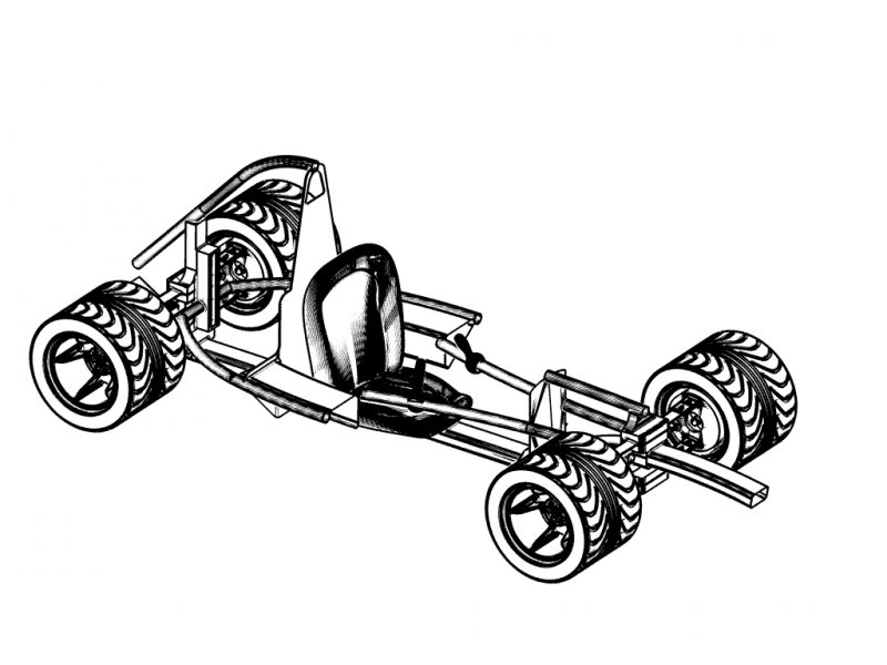

JD Mather Posted September 28, 2011 Share Posted September 28, 2011 Yes. Here is one I did for fun. Quote Link to comment Share on other sites More sharing options...
Vandall Posted September 28, 2011 Author Share Posted September 28, 2011 JD, Thank you for you time on this, you have made me think about the proper way to perform the task. Whilst I have gotten used to handling constraints etc I can now see the huge benefit of using the frame generator. I can even use a dwg. file for the skelton on go from there. I can then use the weldment tool and on to the frame analysis as well. Cool - Thank you. Quote Link to comment Share on other sites More sharing options...
