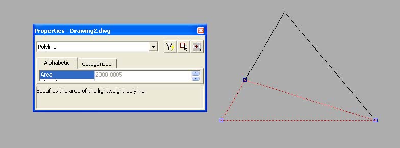

khoshravan Posted October 12, 2011 Share Posted October 12, 2011 (edited) This is more of a trigonometry question, but I want to know if there is an easier ACAD solution for drawing. In the given triangle of ABC (sides and angels are known) I want to draw line CM so that the area of BCM becomes 2000 cm (are of ABC is 5311.7 cm3). Is there an easy ACAD way for drawing this line without using trigonometry for calculation? Edited October 13, 2011 by khoshravan correct title Quote Link to comment Share on other sites More sharing options...
eldon Posted October 13, 2011 Share Posted October 13, 2011 There is a way, but it is not very elegant. Draw the closed polyline BCM. Set up a UCS on side AB. Keep an eye on the Properties (area of polyline) as you drag M along AB. If you have set up the UCS along AB, then using Ortho, point M must stay on the line AB. Quote Link to comment Share on other sites More sharing options...

khoshravan Posted October 14, 2011 Author Share Posted October 14, 2011 There is a way, but it is not very elegant. Draw the closed polyline BCM. Set up a UCS on side AB. Keep an eye on the Properties (area of polyline) as you drag M along AB. If you have set up the UCS along AB, then using Ortho, point M must stay on the line AB. Thanks. This is a good idea although it is not an exact solution but it will satisfy me as I am not looking for exact number. But it would be great if we could program Area box of properties and position of point M as parameter. I think it is not impossible but at leat in a higher than my knowledge level. Quote Link to comment Share on other sites More sharing options...
