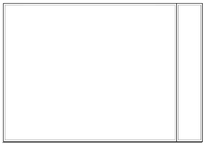

Hi there,
I'm trying to create custom templates that are more bold--a little unique--but still clean professional and would like some feedback:
Right now this is architectural, but I might as well make a mechanical one later.
I'm curious what info you guys like to put on the side? Sheet number and Revisions obviously going on there.
Do you have any pics of your own custom templates with and without logos to share?
All comments appreciated,
Thanks
Company name and logo.
Sheet number.
Drawn by.
Checked by.
Date.
Drawing file name or number.
Revision block.
Space reserved for architect to "stamp" the drawing with his seal.
Scale.
Title of drawing.
Other?
Pretty much as ReMark said. Instead of a stamp we use a signature box (although 95% of the time this is not utilized). We also list the project number on the plan as well as the location of the file on the server (i.e. X/External/Projects/16842/drawing_name.dwg), which is handy if a client or contractor calls up about the plan and you are in a hurry to get a copy of it in front of you.
Of course we are assuming you'll also set up all your layers, linetypes, colors and text/dimension styles too.
