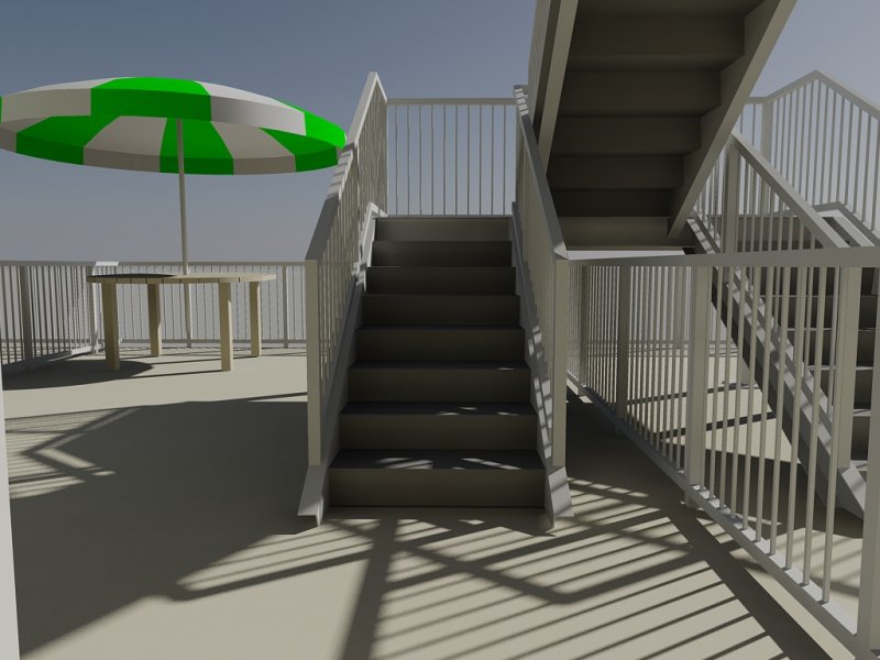

You know I've seen some pretty good stuff as far as a LISP program in the past to take this kind of input and then produce a really great 2d or even 3d model of the stairs. The trouble is that with so many variables it's hard to pin down one set of code which will work on all occurances. But as someone who designs stairs on many occassions I can tell you that AutoCAD is a great tool for doing this work, either in 2d or 3d. Here is an example of a design I'm trying to sell now for a beach front condo. So far, they love the design, but hate the price. The costs for engineering, permits, etc...really adds up. But stairs are a structural item and considered a means of emergency egress and certain steps must be taken....no pun intended.

Bill, your hand rail does not coform to the osha requirements of my .... :P just teasing you, really though, i associate with what your saying as i have to design alot of stairs as well, I've gotten good enough at them that I can do them from scratch in 2d in a couple hours ...... I did have to lay down the law here and force everyone to use MY 'standard' design as what I've seen from others results in some fairly frustrating conflictions, such as not having enough space between stringer run turns to allow for handrail ......
Instead of all that metal had you ever given any thought to using the railings that incorporate wires? Why clutter up a nice view with a lot of metal? It is distracting.
