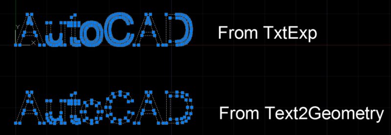

SEANT Posted October 25, 2011 Share Posted October 25, 2011 Yeah, the introduction and Autodesk’s subsequent intention for the Exchange Apps Store has been a bit slippery. The site was originally open to the public. It can now only be accessed via the Exchange button in the InfoCenter toolbar (see below). To makes matters even more nebulous, it is only the Exchange button in “Vannila” AutoCAD. The Apps Tab is unavailable to any of the vertical products (though there have been hints that could change). If Exchange Apps is unavailable see the link EXPLODE TEXT II in SLW210’s post above. With regard to exploded Text/MText: The erratic geometry from TxtExp is multiple closed 2DPolylines. The REGION command can transform all of that geometry in to Regions. The UNION command will combine all the separate polys, now Regions, in to one large, complex Region - while automatically preserving holes and islands. Quote Link to comment Share on other sites More sharing options...
SEANT Posted October 25, 2011 Share Posted October 25, 2011 Here is a comparison of the geometry returned by the two methods, TxtExp/Region versus Text2Geometry: TxtComparison.dwg Quote Link to comment Share on other sites More sharing options...
troggarf Posted October 26, 2011 Share Posted October 26, 2011 (edited) Sean, Your program is awesome. At my old job, one of my tasks was to create a given company's logo in CAD. I didn't like the results of simply putting in a picture found from the internet. So I would find their font (or similar font) and then explode it using the explode text tool in AutoCAD and then spend a lot of time trimming away those inner lines... But your routine makes doing this simple and the text looks great (not all blocky). Thanks dude, ~Greg Edited January 6, 2012 by troggarf Quote Link to comment Share on other sites More sharing options...
