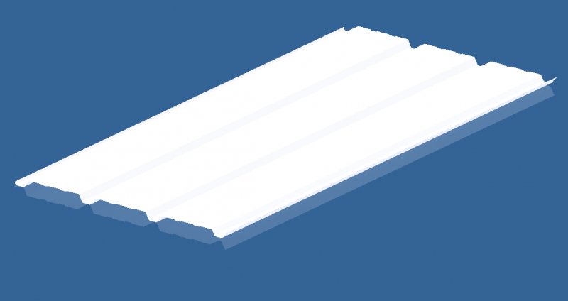

BillB Posted October 24, 2011 Share Posted October 24, 2011 Hi again, Started using 2012 Pro with SP1 and made a part that is modeled after a Flexpro steel panel. When i got done it now has a reflection on one side as seen in the screenshot. I've checked all the different settings under Display and Color in the Application Options and I can't seem to get rid of it. Anybody out there have any suggestions or ideas. Thanks in advance BillB Quote Link to comment Share on other sites More sharing options...
JD Mather Posted October 24, 2011 Share Posted October 24, 2011 I've checked all the different settings under Display and Color in the Application Options... What Reflection Environment? Lighting? Color (material texture)? Attach the file here. Quote Link to comment Share on other sites More sharing options...
BillB Posted October 24, 2011 Author Share Posted October 24, 2011 Here you go J.D., hope it helpsFLEXRIB-10.ipt Thanks BillB Quote Link to comment Share on other sites More sharing options...

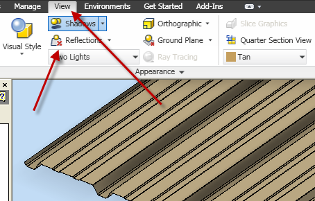

JD Mather Posted October 24, 2011 Share Posted October 24, 2011 Check the View tab for Reflections. Quote Link to comment Share on other sites More sharing options...
BillB Posted October 24, 2011 Author Share Posted October 24, 2011 Thank you J.D.,, that was painless. Strange that when I saved and closed to attach the file here and then re-opened after you answered, the reflection was gone. But I do now know where to look, 2012 is a lot different than 2009 in some ways. Again many thanks. BillB Quote Link to comment Share on other sites More sharing options...
