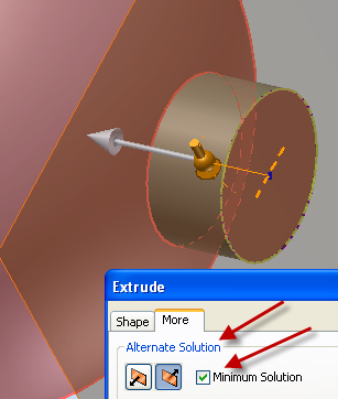

To be perfectly honest, though, I never even thought of trying it this time, probably because I never have much luck with using spherical faces as terminators for extrusion operations. For some reason, the opposite side of the sphere from what I wanted is always where things end up.

To be perfectly honest, though, I never even thought of trying it this time, probably because I never have much luck with using spherical faces as terminators for extrusion operations. For some reason, the opposite side of the sphere from what I wanted is always where things end up.:
There is are options on the More tab of Extrude for Alternate Solution and Minimum Solution, sometimes you have to experiment with these.
At one time (might still be) a question like this on the certification exam.
Ah, good to know. Thanks!
