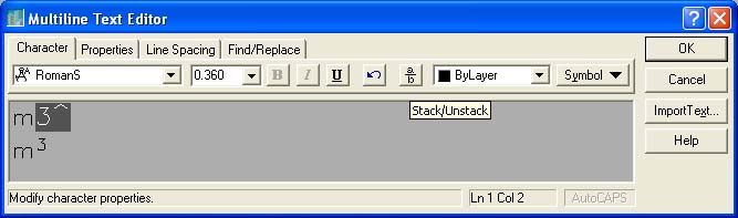

eldon Posted October 29, 2011 Share Posted October 29, 2011 Or in Mtext, type a "^" after the 3, highlight the 3 and ^ and hit the Stack button. Quote Link to comment Share on other sites More sharing options...

mkv123 Posted October 30, 2011 Author Share Posted October 30, 2011 thks its coming in mtest how to do with ordinary text .??? Quote Link to comment Share on other sites More sharing options...
