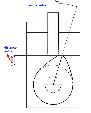

ses4 Posted November 1, 2011 Posted November 1, 2011 (edited) Dear Sir I would like a new parameter for distance value to idw page.And export to excel page. Is it possibble? Ang how does it. Edited November 1, 2011 by ses4 Quote
MarkFlayler Posted November 1, 2011 Posted November 1, 2011 Okay, so this is how its going to work. You are going to have to create a reference dimension in the model with some work features that will represent the value you have here. Then that value can be exported using iLogic to Excel directly or to a XML file instead. If I get time I will put up an example, but it would help if you attached your parts and assemblies so I don't have to redo it all. I am pretty busy prepping 4 classes for Vegas and I may not get time otherwise. Quote
