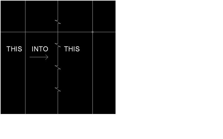

Is their a way to creat a lisp that would make a breakline at the division point saying like 4 space then i get 3 break

Hi and thank you for your time.
This routine does not exactly do what i want but its is close. If it is possible i would like it to had a breakline at each segment of the break. give this image that i posted on this message.
i hope this helps understand.
thanks alot again.

Hi, i know i posted a message yesterday about this request.
I would like to know if there's a routine to creat a breakline according to the scale of the dimension just like the breakline command in Express / draw
Here is a picture of what i would like
Thank alot for all the help.
Cheers to all !!
this is close to what i want. the only thing missing would be dividing the line and at each division input a breaksymbole.
I do not know if such routine exist but i can't find one.
Cheers and thank you!

I got some response but nothing that gives the resolte im looking for. I just don't want to sound rude in how I talk. English isn't my first language and I don't express myself the right way.
I simply don't know how to make it clearer with the picture i sent.
I simply want to recreate a breakline but with more then 1 break. just as if i was using the command "Breakline"
the only difference would be that they would ask how many breaks you want
if you use breakline atm you will get the question middle or something like that
Command: breakline
Block= BRKLINE.DWG, Size= 3, Extension= 1.5
Specify first point for breakline or [block/Size/Extension]:
Specify second point for breakline:
Specify location for break symbol :
i would like a command like this.
