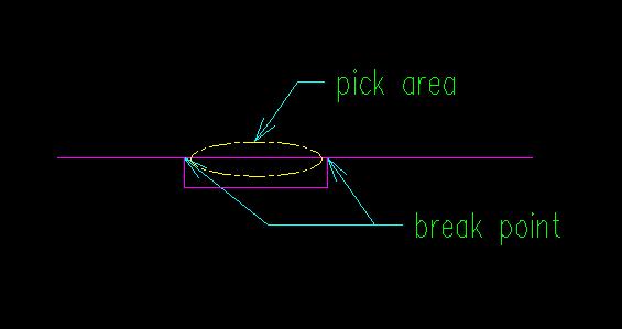

i'm searcing around this forum, many ways for multiselect i found
more than single pick/select to break the object(line/circle)
below code from LeeMac, to break the object with 2 selection
how to hack the code to change with single pick

There are a number of lisp routines that will break a line with a single pick. My question is how many "breaks" are you making? One? More than one? Are you breaking the line by picking another object or the line itself?
pls refer my #1 post with the picture mention
break 2 point and 1 pick point
Sure. If you have a single line, nothing else in your drawing, and you want to break that line at two points, how are you defining the break points relative to the pick point?
yes, this is a tedious task. If you are just picking an object to break you would have to define a number of entities. Breaking a line is different than breaking a circle. (you would have to replace a circle with an arc).
So are you just breaking lines? Or polylines, too?
i want breaking the line only by user pick the line (maybe entsel)
than find the intersection point left and right than break it
Hope this would meet your needs nalsur8 :)

note: pls ignore the yellow color as indicator of pick area
Why did you uploaded the same image once again ?
I can't get your point of view , so finally do you mean that you want to select CIRCLE or ELLIPSE and a line and after that cut the piece
of the selected line which is inside the circle/ellipse area ?
It sounds like the OP wants to break the line where it intersects with either a circle or ellipse. The line segment that is inside the circle/ellipse is retained.
Isn't this very much like a BREAK@ but at two points representing the intersection of the line with a circle/ellipse?
I believe the ellipse is just an indication where the OP wants to pick, its not really there at all
If so , the use of break command would solve the issue without any code .
Am I right ? :unsure:
If that is the case then wouldn't the only method of breaking a line in TWO places using ONE pick involve the user specifying an offset (both sides) of the actual pick point?
Yes something like that.. a fuzz value you might say. which you already suggested a while back.
or write a code to search the two nearest intersection emanating from the point selected then break the line on those two intersection.. I think its easy enough :)
