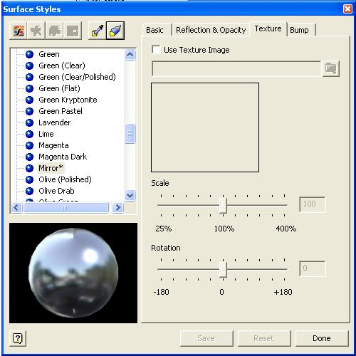

I AM STARTING TO RENDER THINGS IN INVENTOR. BUT I AM HAVING A HARD TIME WITH THE NEW SURFACES THAT I AM BRINGING INTO INVENTOR. I HAVE A POSTER THAT I NEED TO PUT INTO A BEDROOM. I COPY THE BMP AND PUT IT INTO THE SURFACES THEN I GO BACK TO INVENTOR AND CREATE A NEW STYLE. WHEN I PLACE THE STYLE ONTO THE SURFACE WHERE THE POSTER GOES THE SURFACE IS SEPARATED INTO 4 QUADRANTS. MEANING THAT THE POSTER I WANT TO PUT INTO THE RENDER COMES UP AS 4 POSTERS WITH LINES DIVIDING THE SURFACE INTO 4 EQUAL PARTS. HAVE DO I GET RID OF THE DIVISION OF THE SURFACE AND GET MY POSTER TO COME UP AND COVER THE WHOLE SURFACE?

to answer your question, its a problem with the sample size of your material.
so how do i change the size? thank you for your help.

here is a screen shot of my surface styles window. This is what inventor 10-11 look like. Im not sure if 2008 follows the same convention but it should be similar. The scale and rotation slider bars are what you would use. If 100% only covers 1/4 of it try 200%. The preview should be a good indication. I havent done this in inventor before but the layout is the same in other autodesk products.
