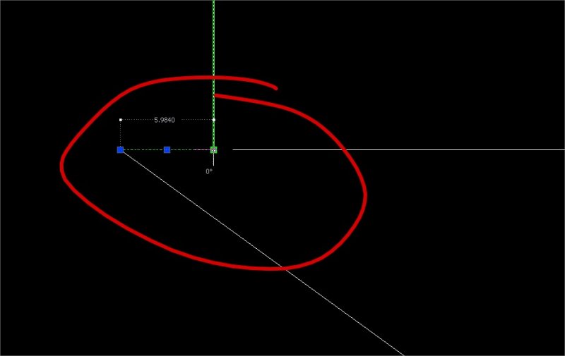

Jamie Moore Posted November 27, 2011 Posted November 27, 2011 Hi everyone, I was a graphic artist for a few years so I'm familiar with design programs like Photoshop and Illustrator. I'm trying to get some metal pieces cut out with a waterjet and they need the format in a CAD file. I recently got AutoCAD 2011 on a Mac and thought I could figure it out. I was wrong. I've watched some videos online but I don't have a good enough understanding of the basics to figure it out. Would anyone be willing to work with me a little? I'm sure we could work something out regarding payment. Thanks, Jamie Quote
ReMark Posted November 27, 2011 Posted November 27, 2011 Just what are you trying to work out? Waterjet? Do you know what file format is required? Could it be done with a DXF file? I'm pretty sure we have had questions of this same type in the past. Quote
Jamie Moore Posted November 28, 2011 Author Posted November 28, 2011 Basically I have a few designs as Illustrator files that I need to either import or recreate in CAD. They aren't very complicated. Waterjet is basically a saw that uses high pressure water to cut out predetermined patterns. I'm assuming that the file can be any format that AutoCAD can read. Do you know if anyone was willing to help? Quote

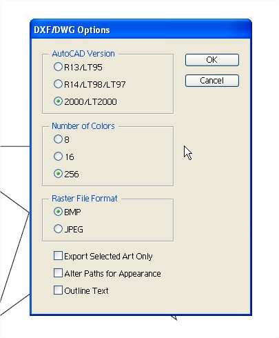

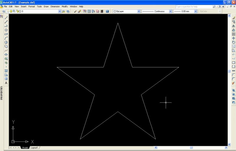

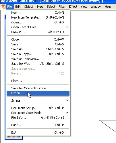

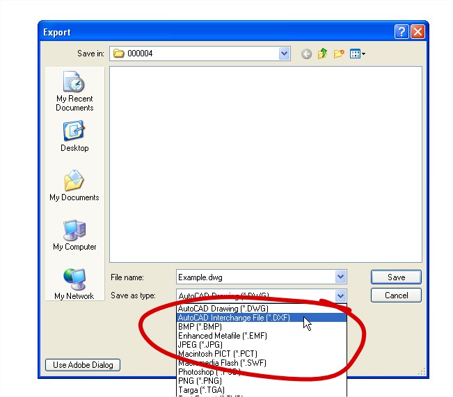

SuperCAD Posted November 28, 2011 Posted November 28, 2011 If the Illustrator files are vector lines, then you can just select everything and export it as a DXF. Then open the DXF file in AutoCAD so you can scale them to the size you need. Quote
ReMark Posted November 28, 2011 Posted November 28, 2011 HCb: While your dissertation was appreciated nowhere within it did you tell us or the OP what output (from AutoCAD) would be acceptable to cut the part on a waterjet. I "guessed" at DXF. SuperCAD's response seems to verify that fact. Care to comment? Quote

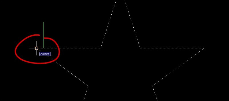

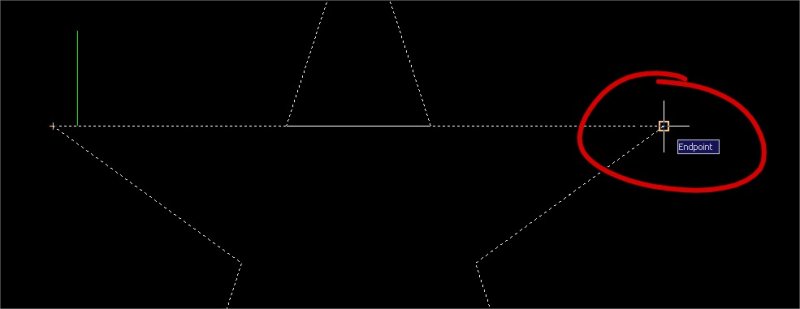

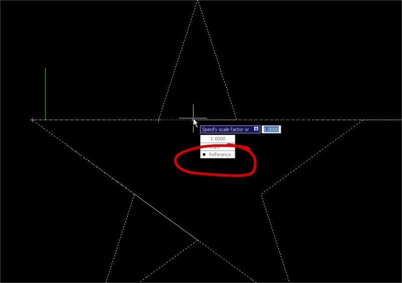

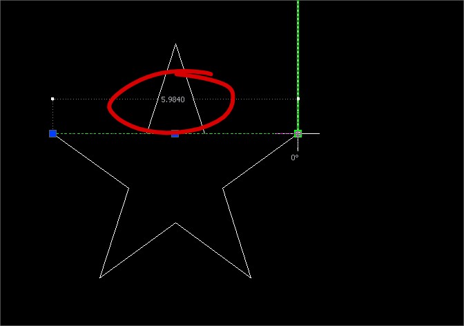

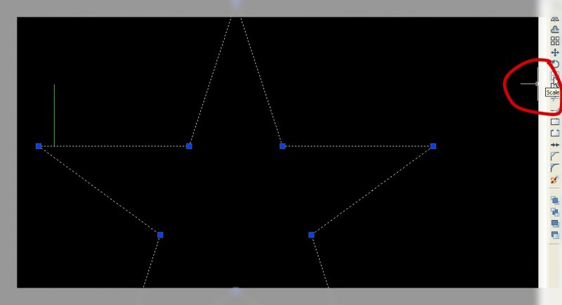

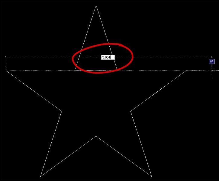

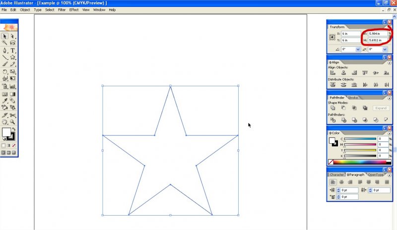

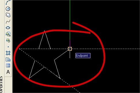

bbankston Posted November 28, 2011 Posted November 28, 2011 DXFs are what waterjet programs normally read. I know because we have a waterjet at our facility. I also am a Graphic Designer that was thrown into the CAD pool. Jamie Moore, do what others have told you, export your file (what you want cut) as a DXF and then use the scale-reference command to adjust the work to it's correct size. Open your file in Illustrator - select all of the artwork - take note of OA height or OA width - export DXF to CAD - draw a line, using the dimension previously notated in Illustrator, horizontally (for OA width) or draw a line, using the dimension previously notated in Illustrator, vertically (for OA length) - you'll notice that your line will be quite smaller than your shape - select your artwork (not the line you drew) - click on the scale command and hit the down arrow key until you come across reference - click on the bottom (if you've drawn a vertical line) and then click on the top of the artwork and make sure you have OTRACK selected at the bottom of your AutoCAD screen and track your line to it's vertical line. I may need to include screen shots to further illustrate how this is done. Quote

bbankston Posted November 28, 2011 Posted November 28, 2011 Here's the screenshot step-by-step: Quote
bbankston Posted November 28, 2011 Posted November 28, 2011 The forum will only let you put 12 pics at a time. Here's the 13th screenshot: Quote

Jamie Moore Posted November 30, 2011 Author Posted November 30, 2011 bbankston, That seems to have worked. Thanks for the pictures, they really helped. I'm getting with the manufacturer later this week. Now, time will tell. Quote
