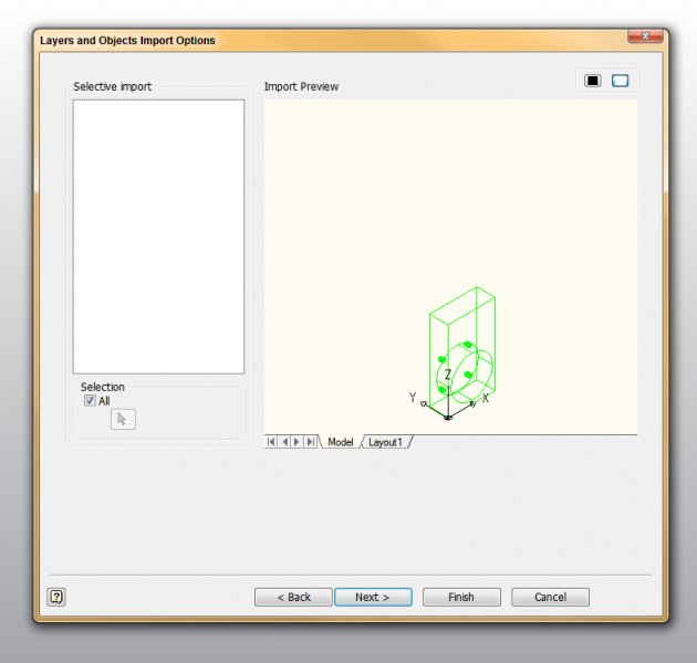

Hello,
I came across this oddity in Inventor 2012 Pro. When I try to Import an exploded block in 2012 the "Layers and Objects Import Options" dialog does not populate the "Selective import" area with layer as it's does in my Inventor 2009 version. It will also not let me pick the objects in the "Import Preview" window. The below images show what I mean. Do I have a setting that's not correct or is this a known problem. I have looked in the Hot Fix area on the Autodesk website but didn't see anything.
Any comments or suggestions on this?
Thanks in advance
BillB

Hello again,
Have even tried just regular 2d Autocad geometry and the Inventor Import function still won't recognize or import into it,,,, very frustrating:x
BillB

Hello J.D., thank you for the response. Here's the current system specs:
Dell Precision T1500, i7 CPU, 8GB RAM, 64-bit O.S., Windows 7 PRO w/SP 1
Autodesk Inventor 2012 PRO with SP 2 w/Update 3, 3Dconnexion Navigator
Has been awhile since I loaded IV 2012 but I am pretty sure that I had anti-virus off but am not sure about U.A.C.
This is something I don't use a lot but I do on occasion, would like it to work that same as it did in IV 2009.
Thank you in advance for any input you can offer on this problem, have a great day.
BillB

Hey J.D., yes sir, have all the Service Packs (1 & 2) and the Update 3 loaded, checked with our computer guy here and we DO have the U.A.C. turned off (or at least the lowest setting).
I did compare and set the 2012 Application Options to the same as 2009 and still no success. Yes, your probably right, may be the install, oh well, not worth reinstall for this small of a matter, will just have to live with it and do what I have done in the past, Copy & Paste.
Thank you again for all your effort, much appreciated.
BillB
