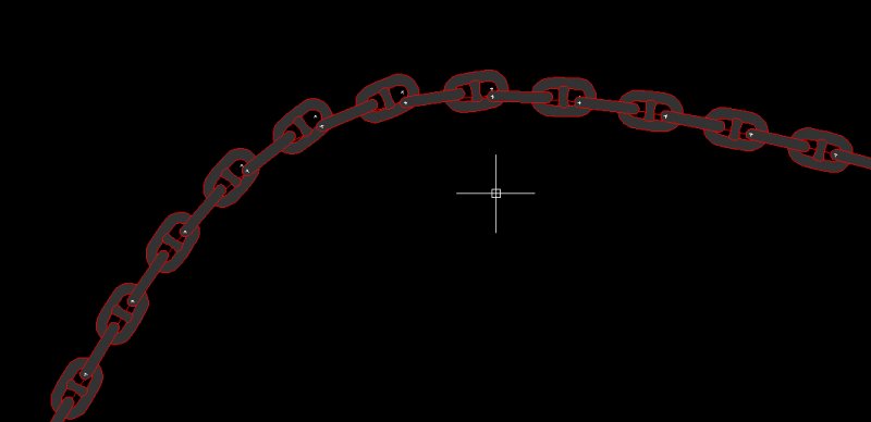

rickh Posted December 5, 2011 Share Posted December 5, 2011 (edited) Hello All, First off, Thanks for this site and everyone that posts on it....I have recieved a lot of great info just reading through forums. This routine arrays selected objects along an arc, spline, pline, helix, at offsets, rotations, etc... -edit- User selects object(s), basepoint of object(s), array path, starting end of path, option to rotate object(s) relative to path - at user defined angle, offset distance, and using Divide or Measure methods of spacing. For Measure option, last option is to place another object at end of path or not. -edit- code updated. Added Max Spacing option. Provide "max spacing" distance, and it calculates the maximum equal spacing between objects along the array path. array-path-2d.pdf array-path-3d.pdf ARRAY_PATHS.lsp Edited November 28, 2014 by rickh code updated Quote Link to comment Share on other sites More sharing options...

pyrohamish Posted November 26, 2014 Share Posted November 26, 2014 Great lisp, is there any way to adjust it so it takes the averag of specified length start and end angle so the end angle along a spline or similar connects with the previous object? Quote Link to comment Share on other sites More sharing options...
rickh Posted November 28, 2014 Author Share Posted November 28, 2014 Hi Pyrohamish, That is a very good suggestion. I'll try to think of a way to incorporate that, but no promises on a quick return. It would be a significant addition to the existing code because of the way the geometry works for that case. You would need to enter 2 basepoints (the 2 ends of the chain link in your example), and both points would need to intersect the array path. On a line, easy...on an arc, easy (just a chord calculation and offset). But where a line changes to a curve across a link, or along a spline, ellipse, etc. that's tricky. The code would need to find where a radius drawn from the first point (radius = the length between the 2 basepoints) intersects the path, and use that as the second point on the array path. So it's not only the angle that is changing. The spacing between points along the array path would also change. I'll definitely be thinking about it, but I don't know how long it will be before I can even get to play with (pretty busy at work lately). fyi, if it's mostly a visual thing, you can try using the centerpoint of the chainlink as your basepoint instead of the end of the chainlink. That would array it along the path closer to the desired result (because the tangent will be in the center). Obviously that's not a precise placement...just a little closer. Quote Link to comment Share on other sites More sharing options...
