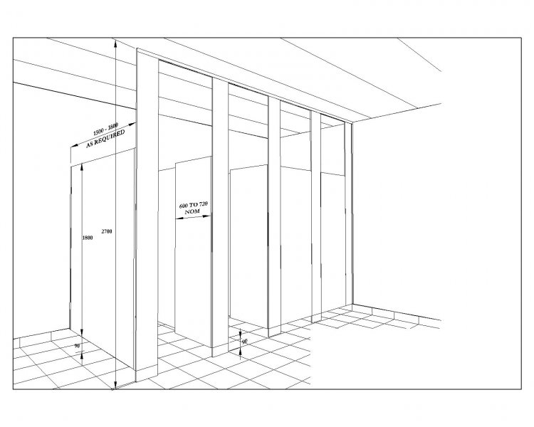

I created a 3d object in AutoCAD 2012. Set a camera at desired location.

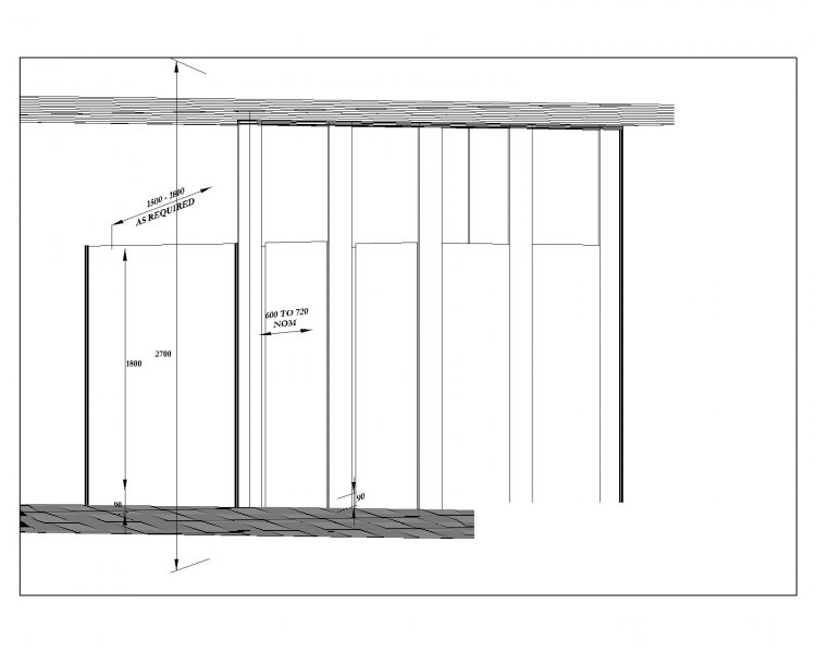

Then switch to paper space, created an mview and set the camera view, then added some mtext and dimensions. Locked the display view, save my work and close AutoCAD. Now here's the exciting part. i re-launch AutoCAD and open the drawing. The drawing was messed up. It does not display the correct camera view that was previously saved. It sounds strange but I do it over and over and same thing happens.
Please help!
Flo
Thanks for the reminder, I updated my profile.
The image on the left (or top) is the correct image. and the image on the right (or bottom) is the image when I re-open the drawing. It looks like it displays the plan view of the camera.
This only happen in camera view. In other viewpoints like SE, NE, SW, NW Isometric viewpoints the image is undisturbed when you re-open the drawing.
