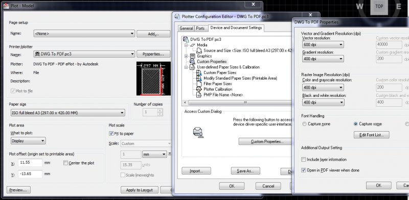

Kemphas Posted December 13, 2011 Author Posted December 13, 2011 I also want to get rid of the pdf's side bar that allows you to see what the layers are and turn them on / off. If i print simply monochrome it will shade the colors into grey's so i dont think thats what i want.. i want 1 color for the program and i want it to simply print BLACK... without having to go in and change all the colors to the layers every time. Quote

AlinOz Posted December 14, 2011 Posted December 14, 2011 I also want to get rid of the pdf's side bar that allows you to see what the layers are and turn them on / off. If i print simply monochrome it will shade the colors into grey's so i dont think thats what i want.. i want 1 color for the program and i want it to simply print BLACK... without having to go in and change all the colors to the layers every time. Kemphas, This is a full AutoCAD, but I'm pretty sure the same will aplly in LT. Open your plot dialogue, select the DWG to PDF plotter. Next to it, you will find a 'Configure' Button. That will take you to the "plotter configuration editor" dialogue. Select Custom Properties in the top area and the Custom Proerties Button will appear at the bottom. Selecting this will open the DWG to PDF Properties Dialogue wherein you will find the "Include Layer Information" checkbox - uncheck it and Bob's yer Uncle... Quote
