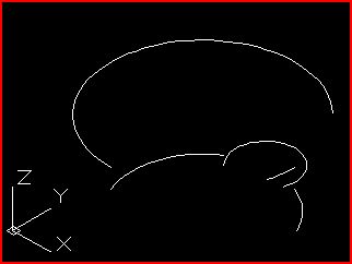

RowanTree Posted December 9, 2011 Share Posted December 9, 2011 Hi all, I'm suffering from CAD rage with this one.... please help! 9 times our of 10, I can't trim away the overlap on a pair of circles... it's sooo frustrating... as every now and then the trim suddenly decides it will work! Here is a screen shot, which will hopefully explain the issue fully... I just can't work out why these pesky circles refuse to trim! I'm trying to merge them into one 'cloud' like shape, by removing the overlapping section from each circle. Any suggestions?! Rowan Quote Link to comment Share on other sites More sharing options...

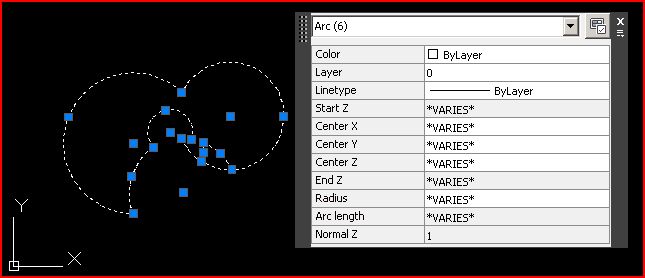

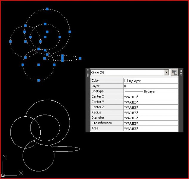

Dadgad Posted December 9, 2011 Share Posted December 9, 2011 ...I know how to trim, and I do seem to be able to trim overlapping circles (sometimes)... however not always. I'm wondering if it is something to do with the angles at which the circles intersect? It's sooo frustrating! I'm only working in 2D... if that helps (both cirles on same layer). Thanks, Rowan The circles on the samples I attached had z elevations ranging by about 4 meters, and I rotated them to different angle on either the X or the Y axis. None of them is touching any of the others. Try trimming something other than a circle? Quote Link to comment Share on other sites More sharing options...
Dadgad Posted December 9, 2011 Share Posted December 9, 2011 The circles on the samples I attached had z elevations ranging by about 4 meters, and I rotated them to different angle on either the X or the Y axis. None of them is touching any of the others. Try trimming something other than a circle? I think you need to check your UCS. Enter UCS at the command line, and see what response you get. I think you need to go to WCS or to reset the UCS which you are in to WORLD. Quote Link to comment Share on other sites More sharing options...
