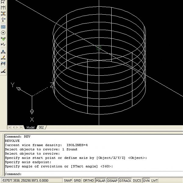

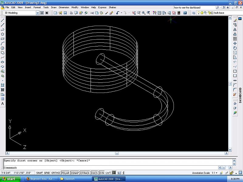

nicnicman Posted October 20, 2008 Share Posted October 20, 2008 How can I trim the "pipe" exactly at the "cylinder"? Thanks for any suggestions. Quote Link to comment Share on other sites More sharing options...
Cad64 Posted October 20, 2008 Share Posted October 20, 2008 Make a copy of the Cylinder and then Subtract it from the Pipe. Make sure the Cylinder is a Solid though. It looks like it was created using Revsurf? Quote Link to comment Share on other sites More sharing options...

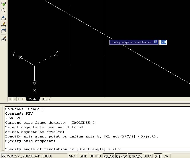

nicnicman Posted October 20, 2008 Author Share Posted October 20, 2008 It was created using Revolve. Quote Link to comment Share on other sites More sharing options...
nocturne00 Posted October 20, 2008 Share Posted October 20, 2008 use slice with the surface option then select the cylynder as your slicing plane SLICE Select objects to slice: 1 found Select objects to slice: Specify start point of slicing plane or [planar Object/Surface/Zaxis/View/XY/YZ/ZX/3points] : S Select a surface: Select solid to keep or [keep Both sides] : Quote Link to comment Share on other sites More sharing options...

nocturne00 Posted October 21, 2008 Share Posted October 21, 2008 The cylinder (w/c is the slicing object) was made using revolve as nic stated so its a surface, not a solid, it can work as a surface when slicing solids Quote Link to comment Share on other sites More sharing options...
shift1313 Posted October 21, 2008 Share Posted October 21, 2008 doesnt revolve make a solid and revsurf make a surface? im not sure what i did lately but my solid extrusion look like his cylinlder with multiple defining lines that in 2d shade mode look like a surface. Quote Link to comment Share on other sites More sharing options...
nocturne00 Posted October 22, 2008 Share Posted October 22, 2008 when you revolve a single polyline, you get a hollow surface Quote Link to comment Share on other sites More sharing options...
nocturne00 Posted October 22, 2008 Share Posted October 22, 2008 Revolving a single polyline also works in making sufaces. See here Quote Link to comment Share on other sites More sharing options...
nicnicman Posted October 26, 2008 Author Share Posted October 26, 2008 I ended up revolving as a poly line to make a solid. Then copied the cylinder in the same place and used the subtract command. Thanks everybody! Quote Link to comment Share on other sites More sharing options...
