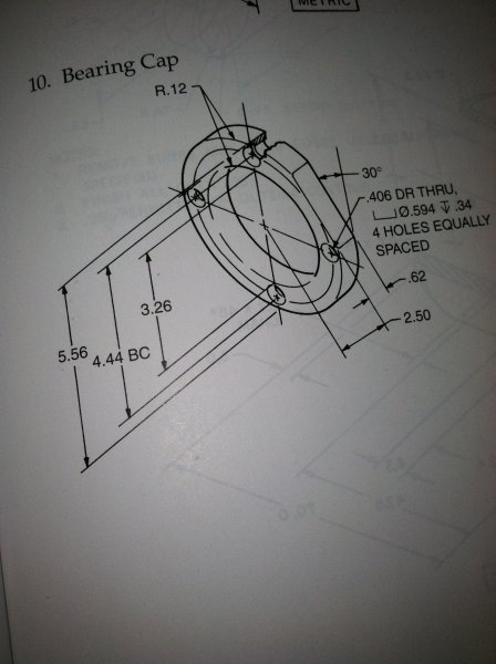

i have to draw a STOP BRACKET and BEARING CAP
i have no idea how to make these anyone can help me ?

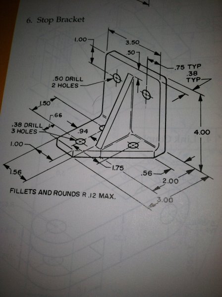

here you go, im working on the stop bracket its just not working for me :o
Are you trying to recreate these isometric drawing perspectives, or are you meant to do standard orthogonal views? Can you do a simple orthogonal view 2D drawings in autocad?
I just actually figured out how to make it :P
but the bearing cap i have no idea haha
and this is the "multiview" drawings section
so you have to draw top right side views

Your top view and your side views are identical except for the locations of the lines which will define the locations of the flat area.
personally, i think the easiest way to draw the bearing cap is to draw the front view with polylines,

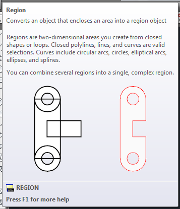

then make make regions out of it,

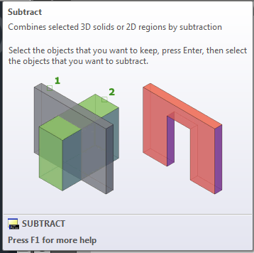

then use substract,

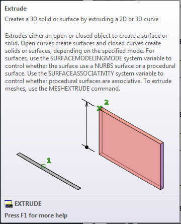

then use extrude to give the cap the right height,

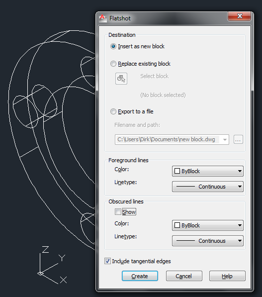

then make a flatshot and insert it.
