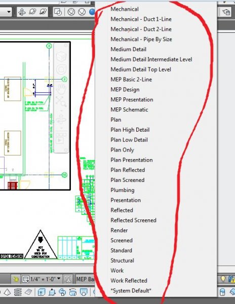

dumfatnhappy Posted December 19, 2011 Posted December 19, 2011 Does anyone know where these live? can't find in display or style managers. I want to copy them to another dwg. Thanks, Quote
dumfatnhappy Posted December 19, 2011 Author Posted December 19, 2011 AecDisplayManagerConfigSelection is what comes up at the command prompt.... I call them Display settings.... depending on what discipline you want to show up when/where... Quote
dumfatnhappy Posted December 19, 2011 Author Posted December 19, 2011 nevermind, I cound em under Display manager (configurations_) daoh! Quote
