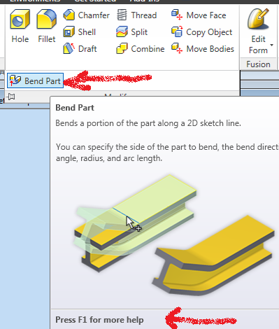

JD Mather Posted December 30, 2011 Posted December 30, 2011 Bend Part. When are the holes created in the real world - before or after bending (it makes a difference). If you aren't going to fully constrain your profile sketch - you should at least make it a Sketch Block. Also - you might install the Service Packs for 2011. Quote
