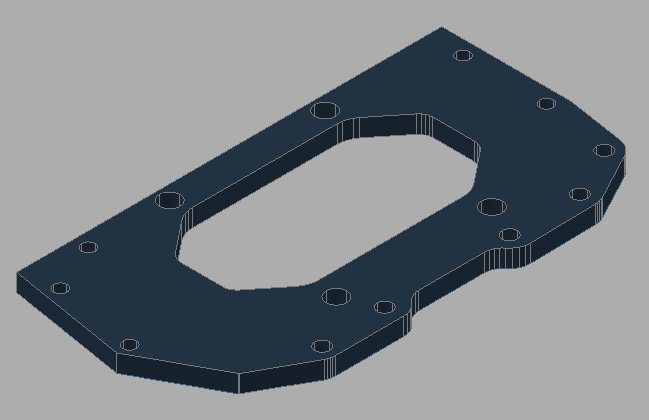

An example of a portion of your object created as a 3D solid.
I think this is more like what you were trying to achieve with your drawing, right?

If you fix it up I would be happy to convert to IGES for you, but the GIGO principle applies (Garbage In = Garbage Out), so it would be best to spend some time learning osnaps, pe j, extrude, subtract or presspull.
There are a bunch of 3D tutorials in my signature - but they assume basic 2D knowledge of osnaps.
well this is what i started out with and then i was just trying to make it 3d and thought i had to do that by extruding it. ReMark, thats pretty much exactly like what i was looking to do with it. i dont have much experience with this stuff, im definitely a beginner.
