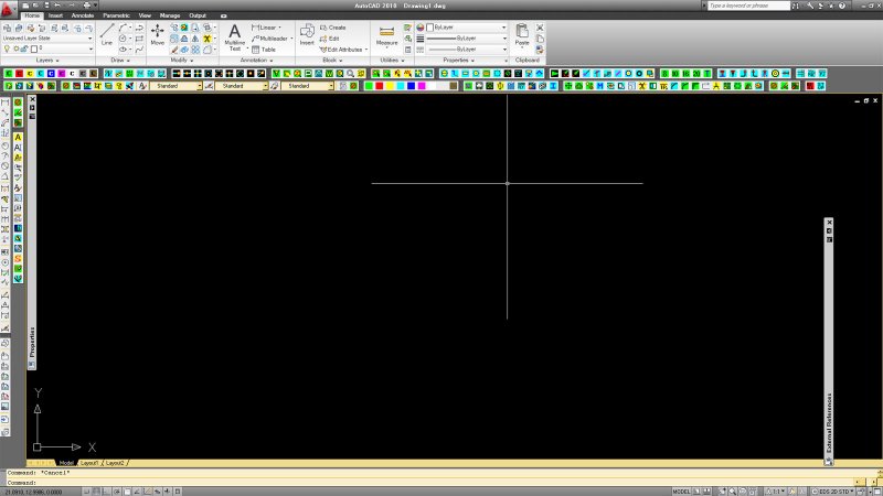

edion2 Posted January 5, 2012 Share Posted January 5, 2012 Hello, I am on ACAD 2010. I use a customized screen menu. I can't work without it. I did something and the width of the screen menu changed and I can only see half of the displayed text. No problem I thought. I went to change the width, but while trying to drag the screen menu into the drafting area, I accidentally double clicked the screen menu header. IT DISAPPEARED ! Now I can't get it back !! I went through the "option" dialog box but the "Display Screen Menu" box has a check mark. I unchecked it . . . clicked "apply" . . . added back the check mark . . . clicked "apply" . . . STILL NOTHING !! I opened the CUI dialog box and under the "workspace property" the screen menu is set to "On". I'm lost as what to try next. I'm sure its an easy fix. Can someone tell me how to get my Screen Menu to show up again ?? HELP ?! . . . Thanks Ed Quote Link to comment Share on other sites More sharing options...

edion2 Posted January 5, 2012 Author Share Posted January 5, 2012 SLW210, Ah, Clipboard . . . The one software I used "print screen" had a folder for saving screen images. Here is my ACAD screen: On the right side of the screen, between the "X-Ref Palette" and the edge is the space usually occupied by me screen menu. Does this help? Thanks Ed Quote Link to comment Share on other sites More sharing options...

edion2 Posted January 8, 2012 Author Share Posted January 8, 2012 Y I P P I E E E E E E ! ! ! ! ! ! :D MY SCREEN MENU IS BACK !!! I found a solution quite by accident. I use 2 screen. The screen I do my work on is a 42" 1080P 1920x1080 screen. My laptop resolution is a bit less, 1600x900. I was going to a friend's home to do some work and took my computer. Any software moved to the second monitor, like my Firefox for the internet, and "closed" while its on the second monitor won't appear on my laptop screen if I don't disable the dual monitor mode. So I disabled it before going to my friend's home. After I got home, I started Auto Cad. It opened on my laptop screen. A window was open, very small, on the top left corner of the screen. When I dragged the corner . . . ITS MY LOST SCREEN MENU !! I thinks it was a problem of DUAL SCREEN MODE. If this happens to you, drag Auto Cad to the primary screen and close it there. Disable dual screen mode and restart Auto Cad. That should bring back the screen menu. Many of my custom toolbar just brings up the screen menu that contains all my custom commands so all my library blocks and many shortcut commands were not accessible. I'm just glad to be back working efficiently. Thanks Ed Quote Link to comment Share on other sites More sharing options...

SLW210 Posted January 9, 2012 Share Posted January 9, 2012 So it was hiding behind the AutoCAD window. 1 Quote Link to comment Share on other sites More sharing options...
