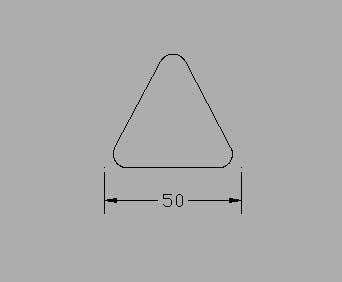

AsyJ Posted January 8, 2012 Posted January 8, 2012 Hello, How I need to modify dimension style if I want to get like in my given picture? Quote
ReMark Posted January 8, 2012 Posted January 8, 2012 You want to make sure your dimensions are above the dimension line. Quote
AsyJ Posted January 8, 2012 Author Posted January 8, 2012 I know how make them above dimension line. I want to know how make dimension line style ''triangle'' to get dimension . Quote
ReMark Posted January 8, 2012 Posted January 8, 2012 What makes you think the triangle was created via the dimension style? Quote
AsyJ Posted January 8, 2012 Author Posted January 8, 2012 I said ''triangle'' because I don't know how to describe this style. I just want to know how create this dimension style like in picture. Quote
ReMark Posted January 8, 2012 Posted January 8, 2012 Draw a triangle. Then add your dimensions. Quote
AsyJ Posted January 8, 2012 Author Posted January 8, 2012 Of course. Why I don't think that? I thought about that. I just wondering, maybe here are dimension style of line like in picture. So if there aren't way to put dimensions you can add extra lines and then put them... Thank you ReMark. Quote
ReMark Posted January 8, 2012 Posted January 8, 2012 I bet it would have eventually crossed your mind. You're entirely welcomed. Quote
Dana W Posted January 8, 2012 Posted January 8, 2012 That is not a triangle, it is an arrow. What you have there in your dimension style is a solid filled arrow. Go to your dimension style editor and change the arrow to what you would like to use. Click the Symbols and arrows tab in the dimension style editor (manager). You will see a dropdown list of arrow types. I think what you are looking for is either the Right Angle or the Open 30 arrow type. Also, you can create your own arrow type in the block editor and then use that by selecting it from the "User Arrow" selection in the above mentioned dropdown list. Quote

Dana W Posted January 9, 2012 Posted January 9, 2012 (edited) Did you read the OP's post #8? I'm pretty sure this thread had nothing to do with solid filled arrows. Yup, I did read it. I'm thinking the OP is busy drawing his instead of "Triangles" to build his dimensions piecemeal. I'm stickin' with it being as simple as the OP not having the English word for Arrow. Of course, I have been known to run into the fire instead of away from it before. Edit: Having re-read everything, it could go either way. I will stick to my idea of the language barier for now since I can't open that drawing. Another Edit: OK, I finally opened 33.dwg and looked at it. I had to go find TrueView. My Cad is too old. There is no triangle in the drawing, so you are ahead on points, and I am either insulting the inteligence of Asyj, or assuming too little of him/her at the least. But. since Asyj went to the trouble of creating that little pictogram of a dimension line, I might have used it to go off on a tangent. The triangle Asyj speaks of is a set of manually drawn in place 'extension lines' used to illustrate the apexes of a "Triangle" that might be created if the shape in the center of the object did not have radiused verte... How do you spell the plural? I am guessing the machine shop needs the size of the triangle for some unknown reason. I would prefer the drawing had more space between extension lines and object lines. I originally ignored the triange thinking it was some sort of shape on the object even though the OP highlighted it. I could not imagine not being able to draw that, after having gotten those lines and arc's to be tangent. Maybe I am the one with the language barrier. I have some crow on hand, and a box of frozen piecrusts to bake them in. Edited January 9, 2012 by Dana W Third fourth and fifth re-think. Quote
Dadgad Posted January 9, 2012 Posted January 9, 2012 Yup, I did read it. I'm thinking the OP is busy drawing his instead of "Triangles" to build his dimensions piecemeal. I'm stickin' with it being as simple as the OP not having the English word for Arrow. Of course, I have been known to run into the fire instead of away from it before. Edit: Having re-read everything, it could go either way. I will stick to my idea of the language barier for now since I can't open that drawing. Another Edit: OK, I finally opened 33.dwg and looked at it. I had to go find TrueView. My Cad is too old. There is no triangle in the drawing, so you are ahead on points, and I am either insulting the inteligence of Asyj, or assuming too little of him/her at the least. But. since Asyj went to the trouble of creating that little pictogram of a dimension line, I might have used it to go off on a tangent. The triangle Asyj speaks of is a set of manually drawn in place 'extension lines' used to illustrate the apexes of a "Triangle" that might be created if the shape in the center of the object did not have radiused verte... How do you spell the plural? I am guessing the machine shop needs the size of the triangle for some unknown reason. I would prefer the drawing had more space between extension lines and object lines. I originally ignored the triange thinking it was some sort of shape on the object even though the OP highlighted it. I could not imagine not being able to draw that, after having gotten those lines and arc's to be tangent. Maybe I am the one with the language barrier. I have some crow on hand, and a box of frozen piecrusts to bake them in. The VERTICES from spelling hell. Quote
