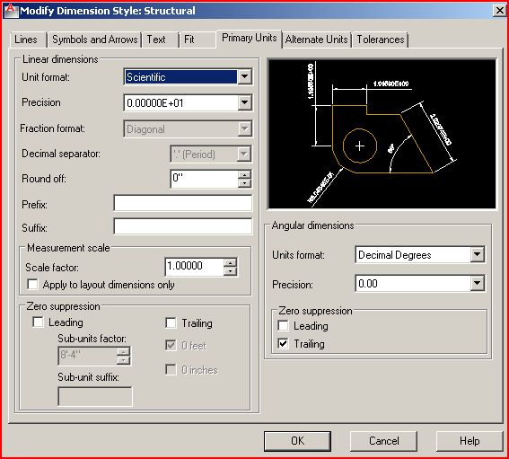

You might also want to modify the dimension style which is being used, perhaps decimal, engineering or architectural or one of the other settings would be more to your liking for the unit formatting in the primary units settings.
