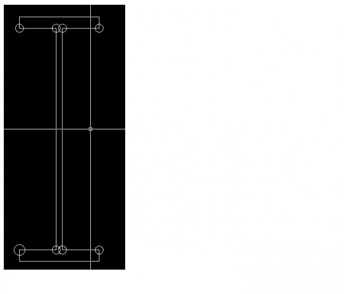

Right on!!!
Now I only have to give a radius to some corners.
Here's a picture :
i have circled the corners that i would like to input a radius.
the radius is the variable R in the code at the beginning
but since i'm not sure how i could make them.
i know i could make a "fillet" with lines but since a "pline" is only on entity and not several i'm not sure how to proceed.
I would need a hit to help me out if you wouldn't mind.
Thank
Cheers beers !
Are the inside faces of the flanges perpendicular? Or are they sloped? I'm working on my own steelwork program too, but I'm getting all the data formatted first before I move on to the part of drawing the sections.
Hai Cadfrank,
Try this code for I Beam
(defun c:IBM (/ O L H EA ES R)
(setq O (getpoint "\nSelecte the point of origine : "))
(setq H (getreal "\nGive the depth of the beam 'd' : "))
(setq L (getreal "\nGive the width of the flange 'b' : "))
(setq EA (getreal "\nGive the web thickness 'w' : "))
(setq ES (getreal "\nGive the flange thickness 't' : "))
(setq pt1 (polar O pi (/ L 2)))
(setq pt2 (polar pt1 (/ pi 2)ES))
(setq pt3 (polar pt2 0 (/(- L EA) 2)))
(setq pt4 (list (car pt3)(+ (cadr O) (- H ES))))
(setq pt5 (list (car pt1)(cadr pt4)))
(setq pt6 (list (car pt1) (+ (cadr pt5) ES)))
(setq pt7 (polar pt6 0 L))
(setq pt8 (list(car pt7) (cadr pt5)))
(setq pt9 (list(+ (car pt4) EA) (cadr pt8)))
(setq pt10 (list (car pt9) (cadr pt3)))
(setq pt11 (list (car pt8) (cadr pt10)))
(setq pt12 (list (car pt11) (cadr pt1)))
(command "_.pline" O pt1 pt2 pt3 pt4 pt5 pt6 pt7 pt8 pt9 pt10 pt11 pt12 O "")
(command "_.fillet" "_r" R)
(command "_.fillet" pt2 pt3 "")
(command "_.fillet" pt3 pt4 "")
(command "_.fillet" pt4 pt5 "")
(command "_.fillet" pt5 pt6 "")
(command "_.fillet" pt8 pt9 "")
(command "_.fillet" pt9 pt10 "")
(command "_.fillet" pt10 pt11 "")
(command "_.fillet" pt11 pt12 "")
);defun c:
Hai Cadfrank,
Hey thank for the tip works how I want.
