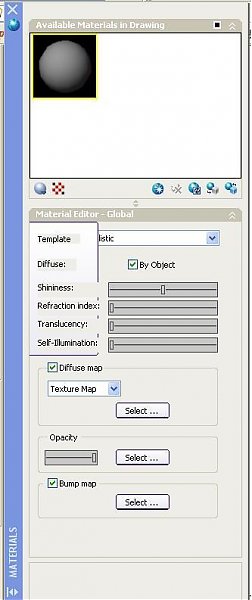

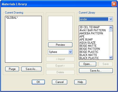

shift1313 Posted October 21, 2008 Share Posted October 21, 2008 The material used on model needs to be sent to your clients and they may need to add it to their drawing as it pulls this from a directory. The Materials preloaded into 06 and 07 i believe are different. Also an acad07 file isnt typically compatable with older versions and needs to be saved as an 04. here are two screen shots, the first is a shot of 07s render mat, the second is 06 the lights should stay with the model but the lighting options in 07 changed from 06 Quote Link to comment Share on other sites More sharing options...
