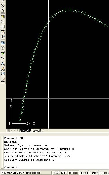

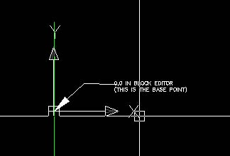

nocturne00 Posted October 22, 2008 Share Posted October 22, 2008 ouch, thats too much of a pain to do; here's how I do it; The first Pic is in Block Editor; The green line is the object I will align, I used its midpoint as the base point. Its important that the coordinates 0,0 in Block Editor(which is the Base Point of your Block to Align) is at a sort of node where it will align on the object you will measure. Quote Link to comment Share on other sites More sharing options...
Primal Scientist Posted October 22, 2008 Author Share Posted October 22, 2008 Absolute QUALITY! Yeah, my block was the problem as it was not at 0,0!! Thank you!!! Thanks for your help! Quote Link to comment Share on other sites More sharing options...
