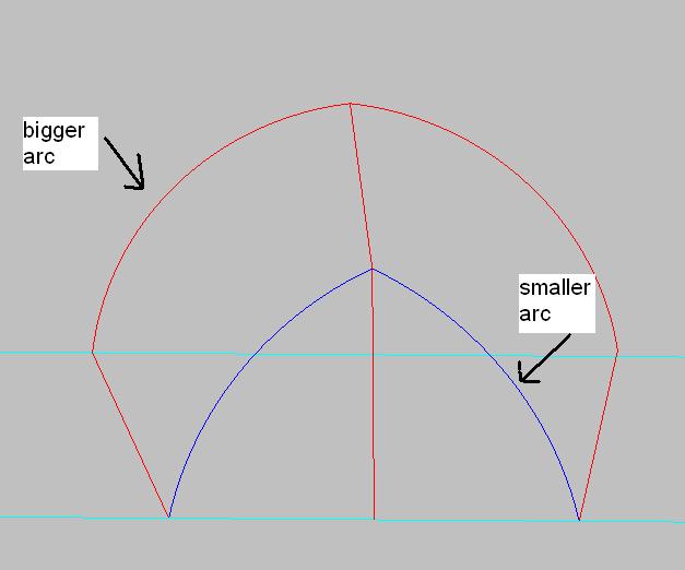

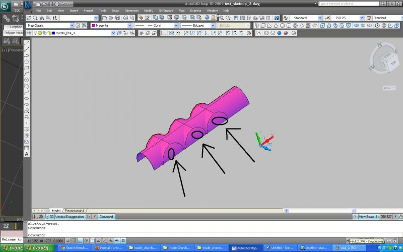

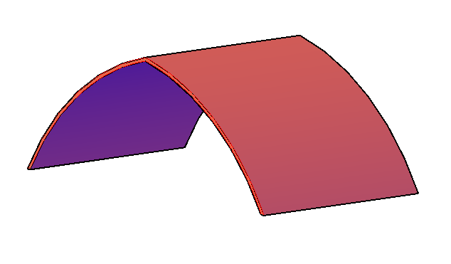

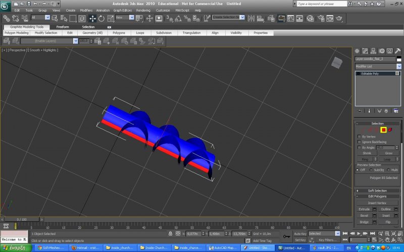

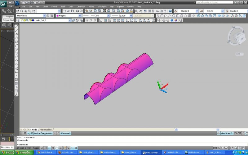

xris_grecia Posted January 14, 2012 Posted January 14, 2012 Hello everybody!! I am trying to create a vault of a church by autocad (foto_1) So i need to eliminate part of the surfaces i ve created using the 'extrude' command at the line drawings of arcs. How can i cut these parts (foto_2)? I ve read about a 'slice' commnad but when i try it i get a message ''no solid objects were selected''. I also tried to manage it with 3dsmax but it chooses the whole polygone (foto_3). The same passes with Sketchup8. I will really apreciate any advice!!!! (p.d. i am not very relative to 3dsmax so i would prefer an autocad solution!) Quote
dedmin Posted January 14, 2012 Posted January 14, 2012 In AutoCAD 2012 You can use trim surfaces to do this. But You are on 2009, so use solid subtraction two times, then explode the solids, remove the unwanted surfaces and combine them.Drawing1.dwg Quote
xris_grecia Posted January 14, 2012 Author Posted January 14, 2012 Thank you a lot for your answer but when i m trying the ''subtract'' command i get a message ''No solids or regions selected.'' I crested my surface by the ''extrude'' command (isn t it suposed to creat solids??) Any more information-idea will really be useful to me!! Quote
JD Mather Posted January 14, 2012 Posted January 14, 2012 You must have closed profile to create solid. Quote
xris_grecia Posted January 14, 2012 Author Posted January 14, 2012 I think i know which is the problem! it maybe doesn t concider my object as solid because its an open surface (foto_1) but i cant extrude the arc and the polyline as one objext (the join command does not let me join polylines with arcs) so that i can get a surface of these elements and then extrude them.. i hope i didn t confus you!!! Quote
xris_grecia Posted January 14, 2012 Author Posted January 14, 2012 To sum up my problem is how to make a solid of the arc and the polyline that units the two edges of the arc. Thank you so much! I really need this information! Quote

xris_grecia Posted January 25, 2012 Author Posted January 25, 2012 Hello!! Maybe i should post a new threat but as my question is relative to creating a 3dsolid in order to be used as part of a vault i m writting here again! i want to make a 3dsolid of a shape like the one in foto_1. (the surface that is visible is actually a mesh not a solid). but if i try the exrtude command i get a result in foto_2. This is because my arcs are not perpenticular (the exrtruding direcion is the perpenticular one_like in foto_2) any advice?? thanks a lot! Quote
xris_grecia Posted January 25, 2012 Author Posted January 25, 2012 excactly!! how have you managed it? Quote
ReMark Posted January 25, 2012 Posted January 25, 2012 I drew an arc then mirrored it. I offset the arcs inward and cleaned up the intersection of the two arcs with the Fillet command. I drew a small line segment from one end of my inner arc and used the fillet command to cleanly intersect it with my outer arc. I mirrored the segment. Using the PressPull command I extruded this profile and rotated the resultant solid into position. Quote
xris_grecia Posted January 25, 2012 Author Posted January 25, 2012 Thank you so much!! I will try it. For any problem i will ask! Thanks again a lot!!! Quote
ReMark Posted January 25, 2012 Posted January 25, 2012 You're entirely welcomed. If you run into a problem with your vault then continue to come back here and seek help. We'll do what we can to assist you. Good luck. Quote
JD Mather Posted January 25, 2012 Posted January 25, 2012 If you already have the surface - you should be able to thicken the surface into a solid. Quote
xris_grecia Posted January 26, 2012 Author Posted January 26, 2012 Thanks a lot for the advice but the thicken command does not work!! my object is not a surface but a polygon mesh ( i created it with the edgesurf command). ReMark!I m stuck here! in the picture_1 is what i understand from your solution (i think i ve misanderstood something!!) If it s what you mean until this point, the fillet command does not clean the intersection of the 2 arcs. Should i use the break command? p.s. the PressPull command extrudes perpenticular the object so i am not sure if it can do what i want beacause i don t need a perpenticular extruding and then rotate it. i need a solid that begins from a bigger arc and fiinshes in a smaller one (foto_2) thanks a lot!! Quote
ReMark Posted January 26, 2012 Posted January 26, 2012 Then use the TRIM command to clean up where the two arcs cross and use the loft command to create your vault. Can you post a copy of the profiles you are working with? Quote
